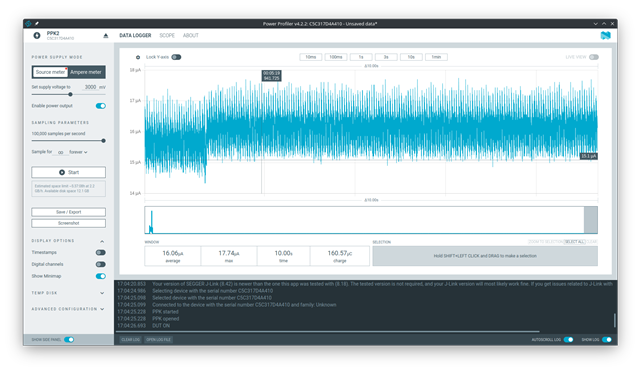

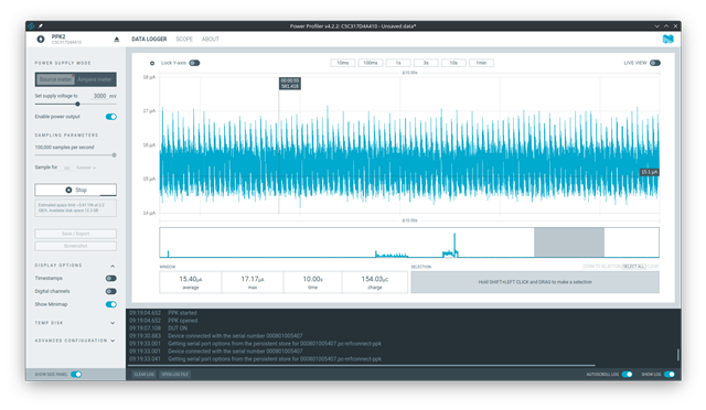

I'm working with a custom board based on the Raytac AN54L15Q module and encountering higher-than-expected power consumption when trying to profile using the system_off example from the nRF Connect SDK.
Current Status
  • Running the system_off sample with modifications to power down the external flash (MX25R64).

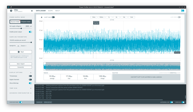

  • Power drops from ~1.86 mA to ~16 μA after powering down the flash.
  • I'm unable to get below ~16 μA, which seems too high for full system_off state.

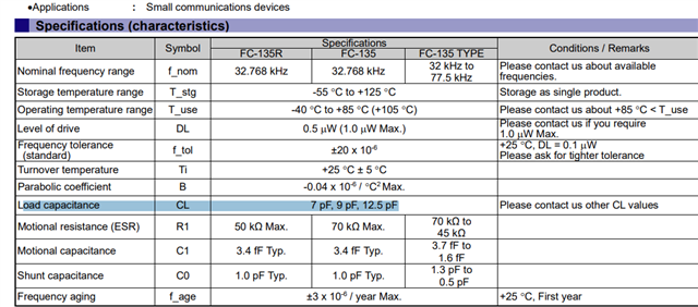

  • LFXO is mounted and using internal load capacitors.
