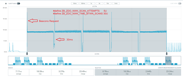

I’m currently investigating ZBOSS and encountered an issue regarding beacon request intervals. I tried modifying #define ZB_ZDO_NWK_TIME_BTWN_SCANS 30U and #define ZB_ZDO_NWK_SCAN_ATTEMPTS 5U, but the changes didn’t seem to take effect. Could you please provide guidance? NCS VERSION is v2.8.0.
