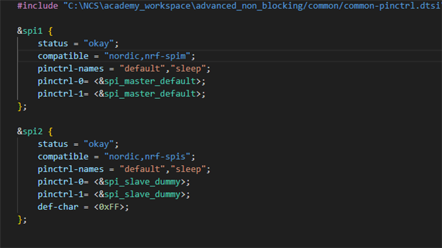

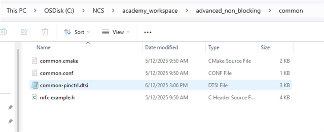

    1. In your overlay file, try to add the actual location of the common-pinctrl.dtsi file. For eg, my dtsi file is in the following location:
    And I have added
    #include "C:\NCS\academy_workspace\advanced_non_blocking/common/common-pinctrl.dtsi"
    in my nrf52833dk_nrf52833.overlay file
    2. The compiler expects two pinctrl properties in the overlay, default and sleep. Since we have no sleep pinctrl defned, please duplicate the pinctrl as follows:

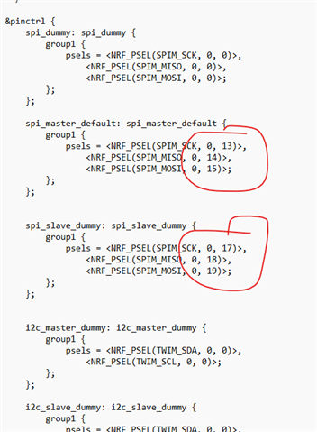

    3. If you check the common-pinctrl.dtsi file, there are no GPIO pin numbers defined. So please add the GPIO numbers, say:
    Please make these modifications and you should be ale to build successfully.
