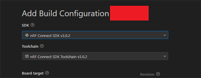

Dear Colleagues,
I selected the #nRF9151-DK, since it was in the list of recommended boards for this course.  It also looked useful for many of the post-evaluation use cases that I have.
So far, my experience is unfortunately that I spend most of the time I have invested in this course in figuring out workarounds for #VSCode problems. I spend very little of my time coding and learning about zephyr and most of it trying to fix VSCode problems.  Use of an IDE that is less-ambitious, more-robust, and more-transparent about how it works would add a lot of value to this course. I think most professionals have a lot of other things to work on, too.  I look forward to getting lesson 2 of the Nordic Devacademy intermediate course, which is about how to use the VSCode debugging features, behind me and getting on to coding some examples.  I don't anticipate using VSCode after this course.
So, here is the current configuration:
SDK:  Zephyr v4.1.99
Toolchain: nRF Connect SDK Toolchain v3.0.2
Board target: nrf9151dk/nrf9151/ns (nordic kit)
Optimization level; Use project default (tried "Optimize for debugging (-Og)", but that failed. Went to the default configuration to take GDB out of the problem equation)

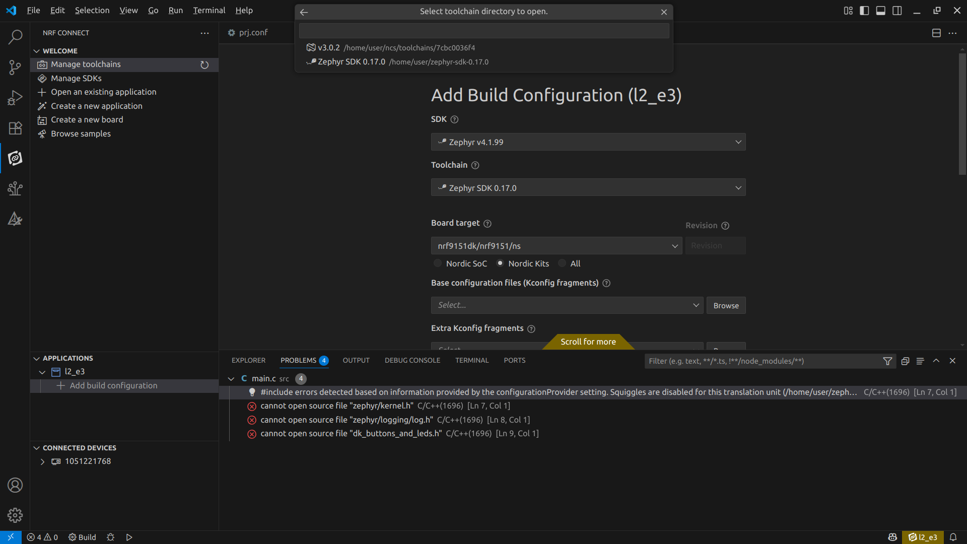

I would appreciate any serious solution ideas.
Thank you,
sonic4

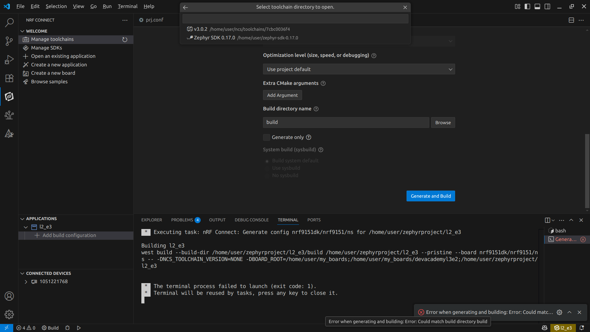

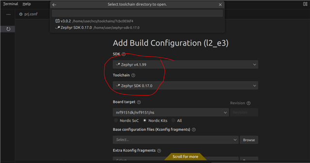

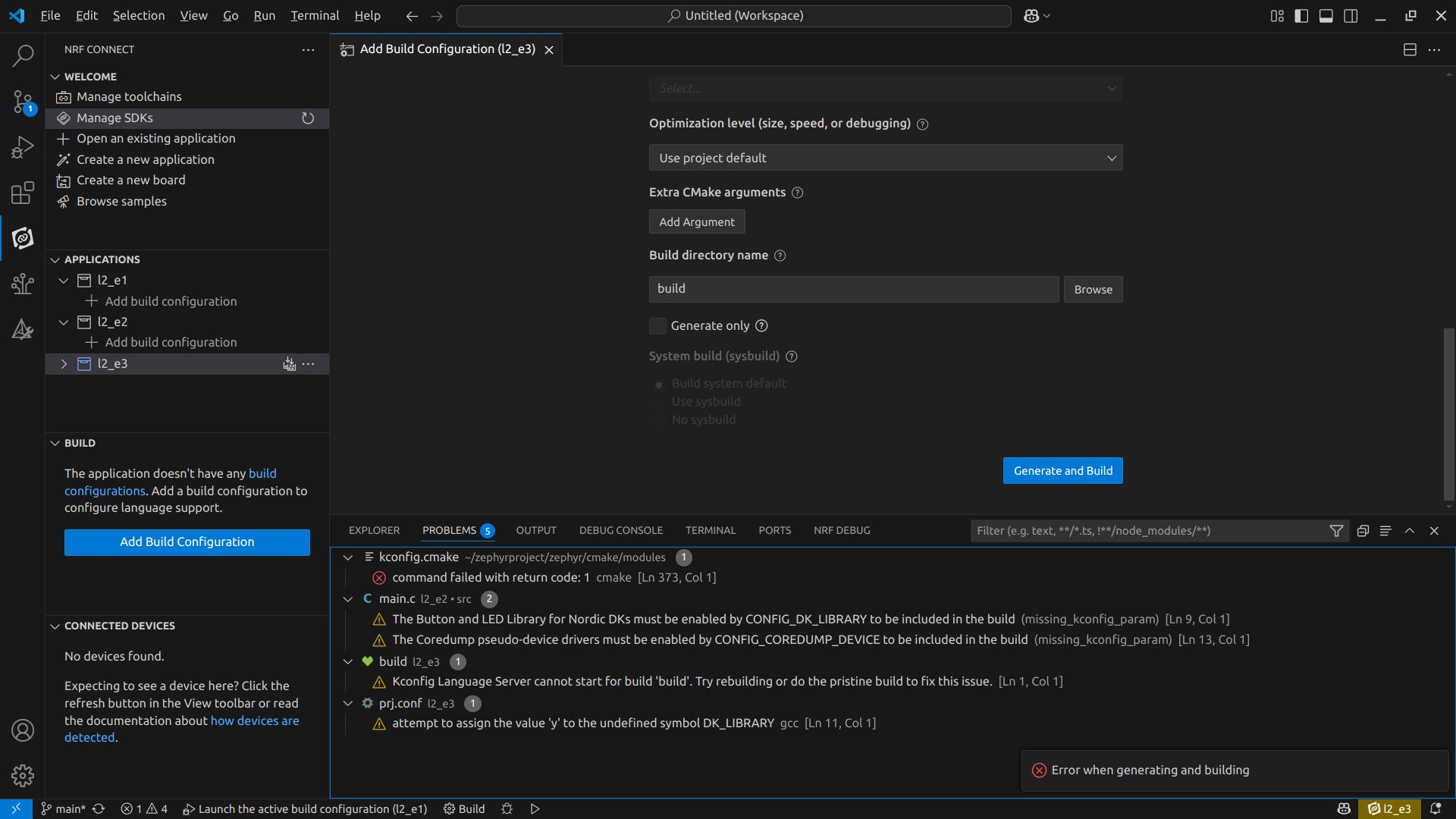

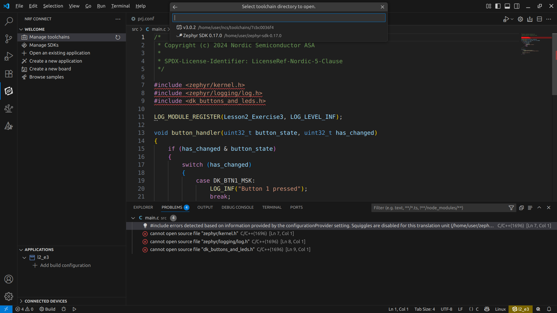

  • Same problem persisting today.  I tried it with example 3 of lesson 2 of the nordic devacademy intermediate course.
    Build Configuration Optimization level set to: "Use project default"
    Here is the "problems" list:

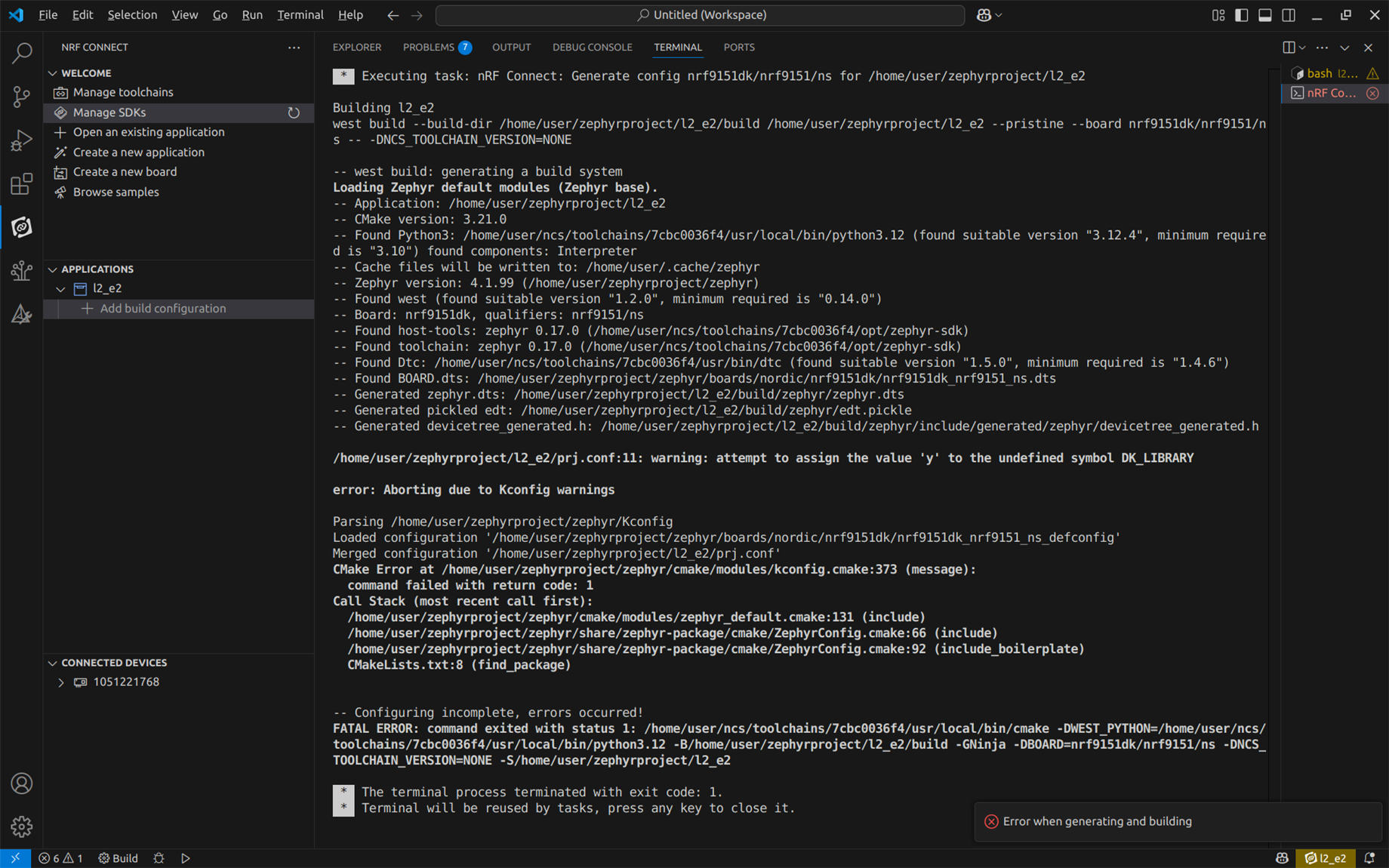

    Here is the text of the failed build that appears in the terminal:
     *  Executing task: nRF Connect: Generate config nrf9151dk/nrf9151/ns for /home/user/zephyrproject/l2_e3
    Building l2_e3
    west build --build-dir /home/user/zephyrproject/l2_e3/build /home/user/zephyrproject/l2_e3 --pristine --board nrf9151dk/nrf9151/ns -- -DNCS_TOOLCHAIN_VERSION=NONE -DBOARD_ROOT=/home/user/zephyrproject/l2_e3
    -- Application: /home/user/zephyrproject/l2_e3
    -- CMake version: 3.21.0
    -- Found Python3: /home/user/ncs/toolchains/7cbc0036f4/usr/local/bin/python3.12 (found suitable version "3.12.4", minimum required is "3.10") found components: Interpreter
    -- Cache files will be written to: /home/user/.cache/zephyr
    -- Zephyr version: 4.1.99 (/home/user/zephyrproject/zephyr)
    -- Board: nrf9151dk, qualifiers: nrf9151/ns
    -- Found host-tools: zephyr 0.17.0 (/home/user/ncs/toolchains/7cbc0036f4/opt/zephyr-sdk)
    -- Found toolchain: zephyr 0.17.0 (/home/user/ncs/toolchains/7cbc0036f4/opt/zephyr-sdk)
    -- Found Dtc: /home/user/ncs/toolchains/7cbc0036f4/usr/bin/dtc (found suitable version "1.5.0", minimum required is "1.4.6")
    -- Found BOARD.dts: /home/user/zephyrproject/zephyr/boards/nordic/nrf9151dk/nrf9151dk_nrf9151_ns.dts
    -- Generated zephyr.dts: /home/user/zephyrproject/l2_e3/build/zephyr/zephyr.dts
    -- Generated pickled edt: /home/user/zephyrproject/l2_e3/build/zephyr/edt.pickle
    -- Generated devicetree_generated.h: /home/user/zephyrproject/l2_e3/build/zephyr/include/generated/zephyr/devicetree_generated.h
    /home/user/zephyrproject/l2_e3/prj.conf:11: warning: attempt to assign the value 'y' to the undefined symbol DK_LIBRARY
    error: Aborting due to Kconfig warnings
    Parsing /home/user/zephyrproject/zephyr/Kconfig
    Loaded configuration '/home/user/zephyrproject/zephyr/boards/nordic/nrf9151dk/nrf9151dk_nrf9151_ns_defconfig'
    Merged configuration '/home/user/zephyrproject/l2_e3/prj.conf'
    CMake Error at /home/user/zephyrproject/zephyr/cmake/modules/kconfig.cmake:373 (message):
      /home/user/zephyrproject/zephyr/cmake/modules/zephyr_default.cmake:131 (include)
      /home/user/zephyrproject/zephyr/share/zephyr-package/cmake/ZephyrConfig.cmake:66 (include)
      /home/user/zephyrproject/zephyr/share/zephyr-package/cmake/ZephyrConfig.cmake:92 (include_boilerplate)
      CMakeLists.txt:8 (find_package)
    FATAL ERROR: command exited with status 1: /home/user/ncs/toolchains/7cbc0036f4/usr/local/bin/cmake -DWEST_PYTHON=/home/user/ncs/toolchains/7cbc0036f4/usr/local/bin/python3.12 -B/home/user/zephyrproject/l2_e3/build -GNinja -DBOARD=nrf9151dk/nrf9151/ns -DNCS_TOOLCHAIN_VERSION=NONE -DBOARD_ROOT=/home/user/zephyrproject/l2_e3 -S/home/user/zephyrproject/l2_e3

    I am sorry for the late reply. We are a bit short staffed these days, but we are doing our best to keep the waiting time to a minimum. I am sorry for the delay and inconvenience.
    It looks like, based on your generated support information, that you haven't installed any version of nRF Connect SDK (NCS). I see that you have the toolchain v3.0.2, but under SDKs, it says:
      "sdks": [
          "version": "v4.1.99",
          "path": "/home/user/zephyrproject"
    What did you select in the very first option when you generated your build configuration?
    If you have not installed nRF Connect SDK v3.0.2, try doing so:
    And follow the instructions to install the SDK. After it has been installed, open VS Code in the SDKs root folder (the folder called v3.0.2, and then add your application to your workspace. Then select both the SDK version (NCS v3.0.2) and Toolchain version (v3.0.2) when selecting your build configuraton. Now it should try to build in NCS, and not in bare Zephyr. Since the CONFIG_DK_LIBRARY is defined in the nRF part of NCS, and not in the Zephyr project.

  • Hi Edvin,
    I was on holiday this week and was away.

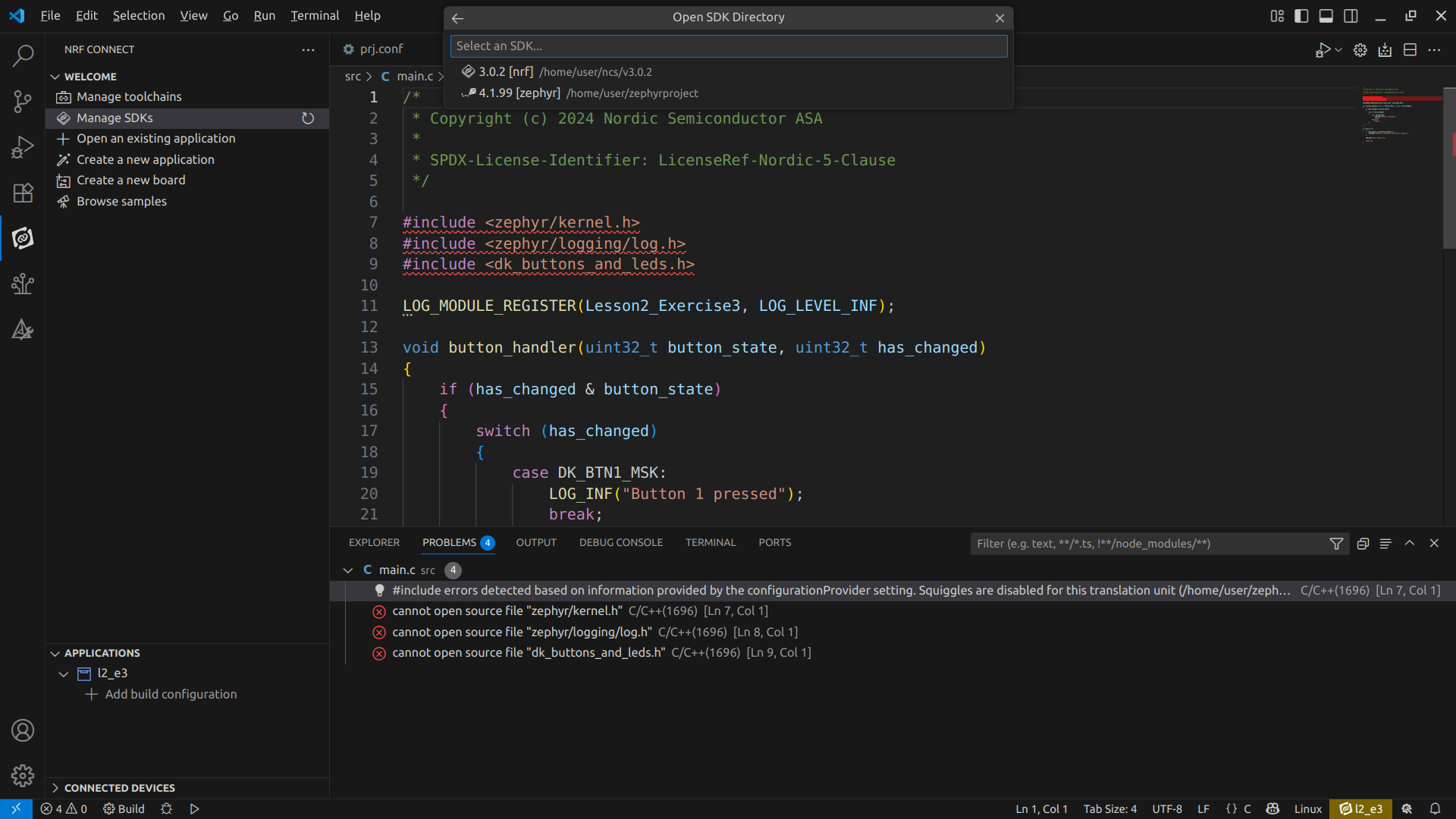

    First the toolchain.  There are two installed.  Here are the options shown me in NRF CONNECT->Manage toolchains -> validate toolchains:
    Two are shown.  I have tried both several times, with zero success.
    Now the SDKs.  NRF CONNECT - > Manage SDKs -> Open SDK Directory
    Two are shown.  As we will see in a bit, even though NRF Connect knows that SDKv3.0.2 is there, it is not selectable in a build configuration.
    I have also tried uninstalling and reinstalling many, many times.  No success.  BTW:  Why is it not possible to do a clean uninstall?  There are always quite a number of files remaining.
    Here is one Build configuration option presented.  When I select it, NRF CONNECT pops up a window that says "validating toolchain".  Apparently the toolchain is valid, since no error messages seem to be visible.
    Under Optimization level, I selected: "Use project default" and clicked "Generate and Build."
    With this combination of SDK and Toolchain, today I get this fine output:

    Now let's attempt to try another combination of Toolchain and SDK:
    First of all, as we see, the v3.0.2 SDK is already installed in a directory.
    Now let's try to add a build configuration with the v3.0.2 SDK / Toolchain combination:
    ...but when I want to change the SDK to v3.0.2, it does not appear in the build configuration options, even though I was just shown that it is there.

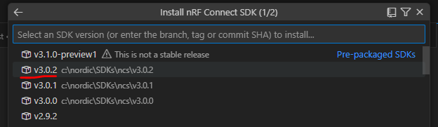

    Just to be thorough, let us uninstall that SDK and re-install it [again], since we want to select it. This time, I will also unistall the Zephyr toolchain.
    Now I have a total crash.  I need to start over with everything.
  • When you are creating your build configuration:
    Set both the SDK and toolchain to v3.0.2, and try to build again.
    Currently, you are trying to set a Kconfig, CONFIG_DK_LIBRARY, which is not defined in Zephyr. It is defined in nRF Connect SDK (NCS), which includes Zephyr in it, but Zephyr alone has no concept of this CONFIG_DK_LIBRARY.
