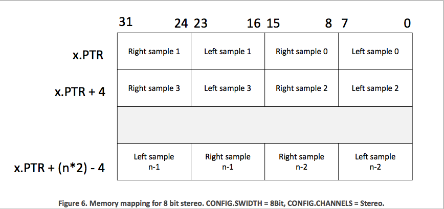

I'd like to output some audio data through i2s. It's quite easy to understand your examples provided on infocenter, however, I can't get my code to work.
Here is what I do:
