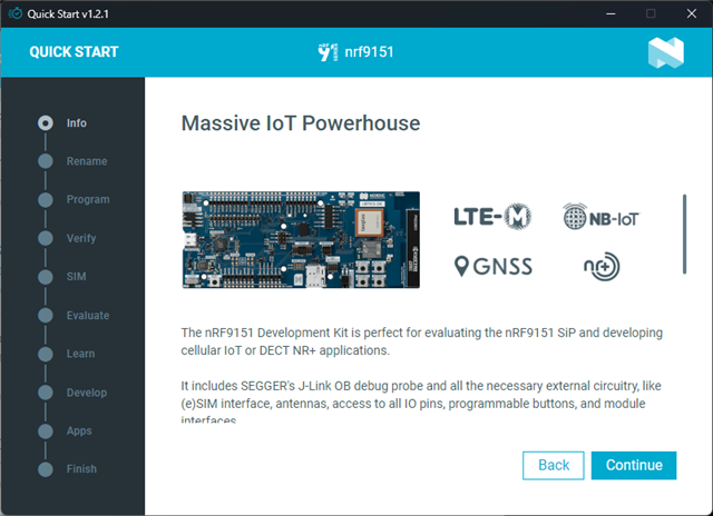

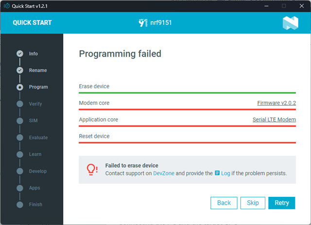

I'm having some trouble connecting to the onboard jlink with the NRF9151 devkit that I've recently received. The quickstart seems to detect the NRF9151 dev kit, but when I attempt to program the example code I run into issues
The log doesn't have super helpful information
2025-06-12T20:28:10.326Z INFO Initialising the bundled nrfutil device
2025-06-12T20:28:10.352Z DEBUG Started watching devices
2025-06-12T20:28:11.740Z INFO Using the bundled core version for nrfutil device: 8.0.0
2025-06-12T20:28:11.763Z INFO Using nrfutil-device version: 2.10.2
2025-06-12T20:28:11.763Z INFO Using nrf-device-lib version: 0.17.71
2025-06-12T20:28:11.763Z INFO Using nrf-probe version: 0.38.0
2025-06-12T20:28:11.763Z INFO Using JLink version: JLink_V8.42
2025-06-12T20:28:11.764Z INFO Your version of SEGGER J-Link (8.42) is newer than the one this app was tested with (8.18). The tested version is not required, and your J-Link version will most likely work fine. If you get issues related to J-Link with your devices, use the tested version.
2025-06-12T20:28:13.328Z DEBUG Selected device: nRF9151 DK
2025-06-12T20:28:13.350Z DEBUG Changed step: Info
2025-06-12T20:28:15.493Z DEBUG Changed step: Rename
2025-06-12T20:28:16.315Z DEBUG Changed step: Program

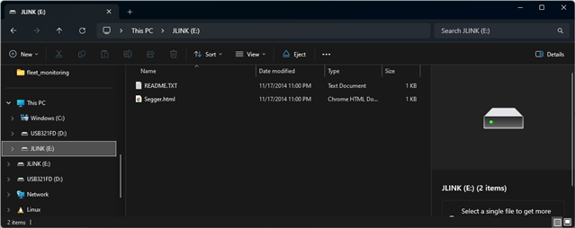

There is a mass storage device that shows up in windows explorer when I plug in the development kit

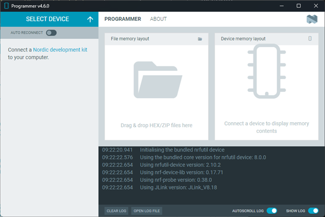

    Unfortunately the development kit doesn't show up in the programmer application:
    Which is sort of odd because the device is found with the "Quick Start" application.

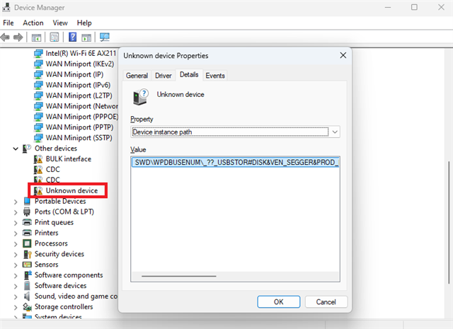

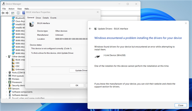

    Another data point is that the onboard jlink doesn't show up when I list the devices using seggers utilities. There is no output from the command.
    J-Link>ShowEmuList
    However if I plug in a dedicated JLINK, the output shows my device
    J-Link>ShowEmuList
    J-Link[0]: Connection: USB, Serial number: 600103367, ProductName: J-Link PLUS
    J-Link>
    This leads me to believe there is a problem with the onboard JLINK. Odd that it shows up with nrfutil,exe but not with jlink.exe, though.
    Let me know what you think I can do from here to recover the device.
