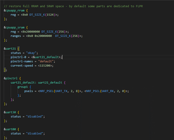

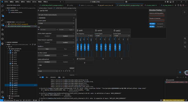

C:/ncs/v2.9.1/zephyr/include/zephyr/toolchain/gcc.h:87:36: error: static assertion failed: "/soc/peripheral@50000000/uart@c7000 defined without sleep state" ,when i use the uart21,it is report this err.why?
Define its sleep state along with default one.
