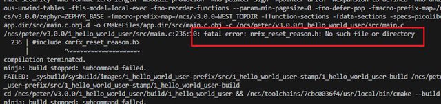

If the following function is used, how to solve this error:
Peter.Min
Hi Peter,
Please take a look at this changelog for the nRF COnnect SDK v3.0.0:
Where it mentions that you need to use the hwinfo instead of the previous reset reason:
Priyanka
Hi Peter,
Priyanka
