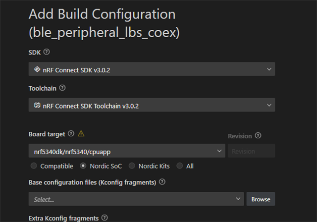

  • Hello Hung Bui,
    Thanks for the update!
    Attached software by you also doesn't support nrf5340dk, do I need to transfer files in new nrf5340 project as previous and then do the changes suggested by you?
    do I need to place prj file from attached project to  prj.conf inside sysbuild\ipc_radio. all or partial?
  • Hi Antendra,
    I don't really understand what you meant by doesn't support nrf5340dk.
    I can build it for nRF5340dk without problem. Simply select the board and you can build it.
    Note that there are two prj.conf. One in the main folder and one in sysbuild\ipc_radio
