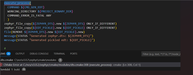

when I try to build a code for integrating sensor in nRF 5340 dk, this error comes, I tried even after installing cmake manually from the cmake website https://cmake.org/, but unable to solve these errors , kindly help with a suitable solution.
SDK version 3.0.2

    Thank you , now when I'm trying to interface sensor,First time it was built but displayed  sensor not detected,but from second time build error is happening, shall I share my .overlay and .dts files
    Regards
    Gouri.K

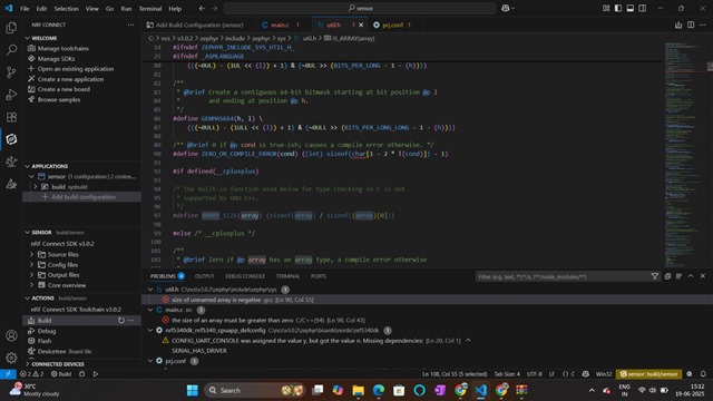

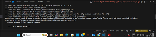

  • From the log:
     error: static assertion failed: "Only one of the following peripherals can be enabled: SPI0, SPIM0, SPIS0, TWI0, TWIM0, TWIS0, UARTE0. Check nodes with status \"okay\" in zephyr.dts."
    Looks like you enabled two of these?

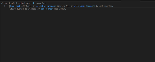

  • Yes,spi0 and spi4 were declared, after that I deleted the pin assignment but  Im continuously getting this error since then ,the empty_file.c is empty though, but the error is pointing there ,I tried reinstalling but the error is still prevailing
