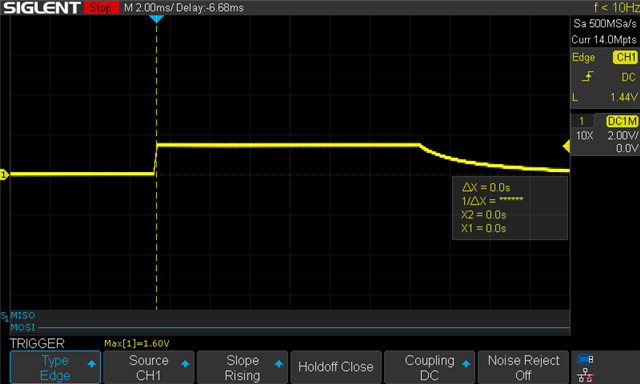

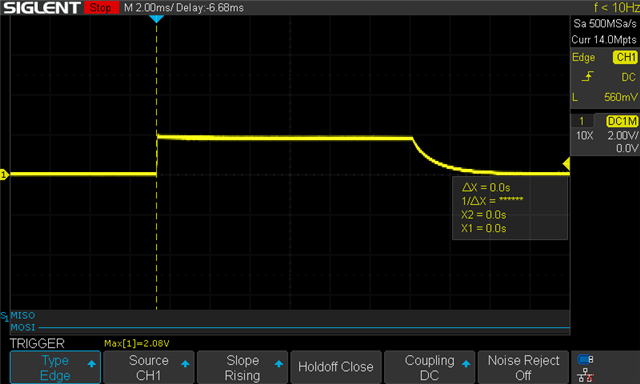

I am also seeing some strange noise right after I reset the nrf54l15 and its is probably trying to initiate the nrf7002
In the image below you see the voltage on the VDD_BUCK Line
And I see something similar on the PWRIOVDD line:
I am not sure where to start debugging here, software or hardware. I hope someone can help me out.

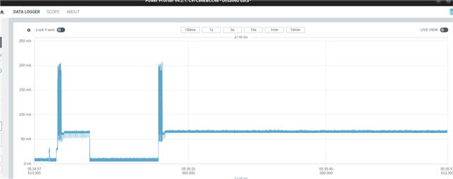

    Together with this one, I also captured the power profiler output:
    With the WiFi shell, I get a set of new errors now, and I cannot perform a wifi scan because interface is not up
