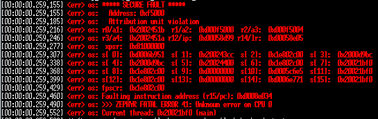

    I am also attempting to implement the coredump feature and store dumps in internal flash. I am defining the partition in pm_static.yml and in the device tree, however when I try writing a dump to the partition I get a Secure Fault (Attribute unit violation).
    I understand that this is related to accessing memory that one is not authorized to access, but this should all have been setup properly using the config settings I would suspect.
    I am unsure how to resolve this and any help/hints would be much appreciated.
