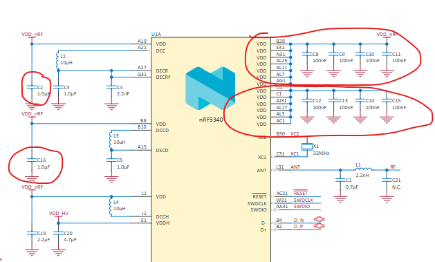

  • Hi Priyanka, Thanks for answering!
    It's our own design, but I largely followed the nrf5340 QKAA reference layout 1_2 suggestion on both revisions.

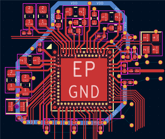

  • Hi Priyanka,
    as this is contract work for a client, I can't share a complete schematic of the project. The differences between both revisions are marginal and only apply to a few GPIO pins. The power supply and clock configuration hasn't changed between revisions, and matches the PDF I uploaded.
    I actually did have the RESET (I assume this is what you meant by " REST"?) pin floating in both revisions, but I added a 10k pull-up to the board that was misbehaving, and it didn't make a difference.

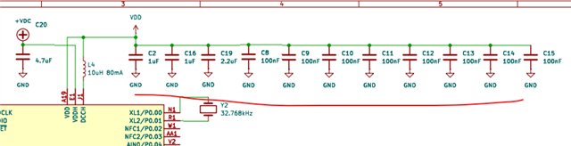

    The schematic seems to comply well with the reference design. I just have one comment though.
    These are correct in terms of the number of capacitors and their values, but please make sure that these caps are placed as close to their pin on the SoC bacuse if they are far away from their corresponding pins, this can cause trouble.
    This is how it's placed in the reference design:
    -Priyanka
