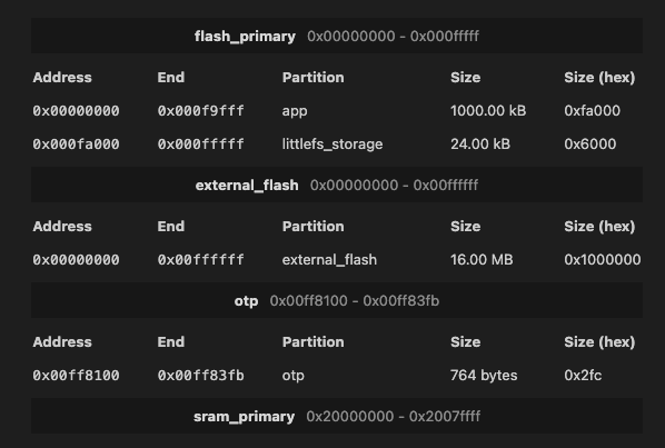

    I actually got it building without the fstab but littlefs_storage is on the primary flash. Is there anyway to size it and ensure it's on external flash?
    If I'm using dynamic partitioning I at least need to get the partions onto the right regions, correct? Also, I need a lot more space on my littlefs_storage partition than what was dynamically created.

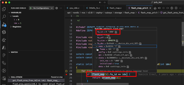

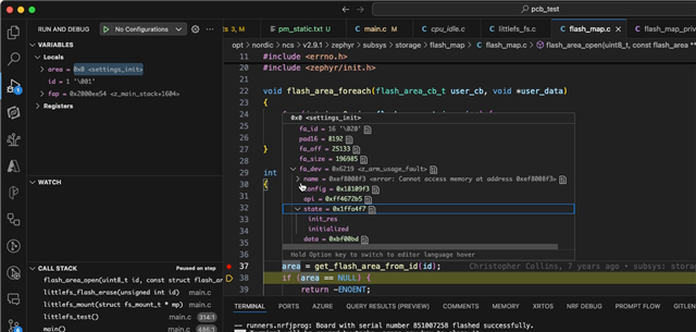

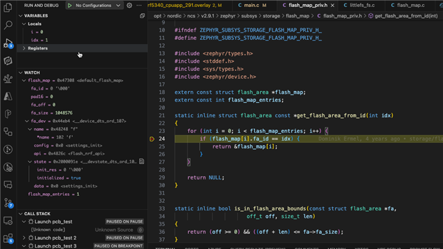

  • Maybe I spoke too soon. I'm getting and error and traced it to:
    static inline struct flash_area const *get_flash_area_from_id(int idx)
    	for (int i = 0; i < flash_map_entries; i++) {
    		if (flash_map[i].fa_id == idx) {
    			return &flash_map[i];
    	return NULL;
    when idx=1, i=0 (first iteration of the loop), and flash_map_entries = 1. flashmap[0] looks like this;
    It errors on an evaluation when there appear to be values to compare.
    and the calling function the area does not appear to be null, although I see a "cannot access memory..." error in there.
    It is called from but fails and -2 is returned.
    	area = get_flash_area_from_id(id);
    	if (area == NULL) {
    		return -ENOENT;
    The calling function was taken from the sample:

    at runtime the mountpoint is:
    type =1
    mnt_point =0x45afc "/"
    fs_data =0x200004e8 <littlefs_storage>
    storage_dev =0x1 <settings_init>
    mountp_len =0
    fs =0x0 <settings_init>
    flags =0 '\000'

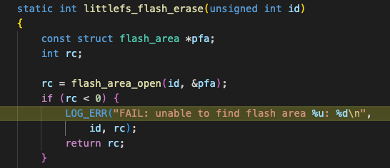

    I did see this: the first initialization sends an error: -19 which is what I am getting but I'm on 2.9.1.

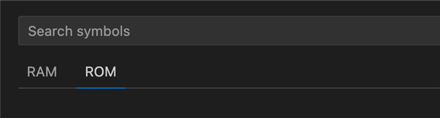

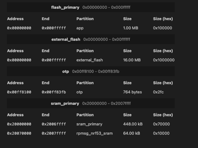

    If it is not too much hassle, can you try to disable the partition manager with SB_CONFIG_PARTITION_MANAGER=n and then try the same?
    Im thinking that it would give us good info if we see the same issue without the partition manager or not.
    Who knows, this could even be  a workaround for you
  • No problem at all. So I need a sysbuild.conf and put that in it, correct?

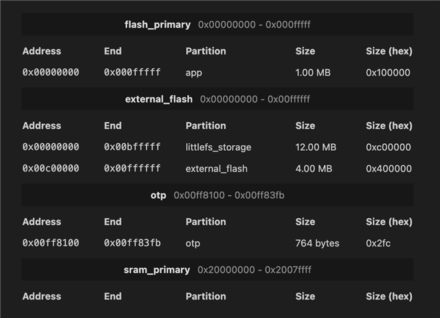

    My memory report shows no partitions when I do that:

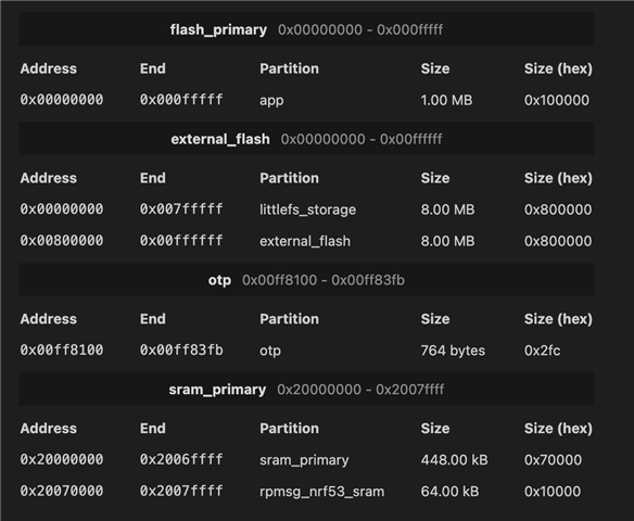

    When I did it without the SB_CONFIG_PARTITION_MANAGER=n I added this to the overlay to see if that was the problem:
    &w25q128 {
    	status = "okay";
      partitions {
    		#address-cells = <1>;
    		#size-cells = <1>;
    		// For Nordic Partition manager to work it has to have this name.
    		littlefs_storage: partition@0 {
    			label = "littlefs_storage";
    			reg = <0x00000000 0xc00000>;
        external_flash: partition@00c00000 {
    			label = "external_flash";
    			reg = <0x00c00000 0x400000>;
    Which matched the memory report:
    Here is where the error happens. I am watching two variables: flash_map and flash_map_entries. You can see flash_map_entries=1. I think I should have >1 according to the memory report. The error happens on the evaluation, so that is also indicative of a problem.
    I added a test to see if the device was enabled. I don't know if this is a proper way to test it or not, but thought I would try:

    We see in the memory report I have the partition and the partitions.yml looks like this in the build directory:
    app:
      address: 0x0
      end_address: 0x100000
      region: flash_primary
    external_flash:
      address: 0xc00000
      end_address: 0x1000000
      region: external_flash
    littlefs_storage:
      address: 0x0
      device: DT_CHOSEN(nordic_pm_ext_flash)
      end_address: 0xc00000
      placement:
        before:
        - tfm_storage
        - end
    otp:
      address: 0xff8100
      end_address: 0xff83fc
      region: otp
    rpmsg_nrf53_sram:
      address: 0x20070000
      end_address: 0x20080000
      placement:
        before:
        - end
      region: sram_primary
    sram_primary:
      address: 0x20000000
      end_address: 0x20070000

    and the function which is erroring is this which is taken from the sample and the id=1 when it fails:
    		rc = flash_area_open(id, &pfa);
    		if (rc < 0) {
    			LOG_ERR("FAIL: unable to find flash area %u: %d",id, rc);
    			return rc;
    I'm watching the flash_map, flash_map_entries and lfs_storage_mount which all look like this on during the error:
    lfs_storage_mnt =
        Node {
            <anonymous union> = {...}
            <anonymous union> #2 = {...}
            type=1
        mount_point = 0x4610c "/" {
            *mnt_point = 47 '/'
        fs_data = 0x200004e8 <littlefs_storage>
        storage_dev = 0x1 <settings_init>
        mountp_len = 0
        fs = 0x0 <settings_init> {
            open = 0x2000f010 <sys_work_q_stack>
            read = 0x6345 <z_arm_reset>
            write = 0x30819 <z_arm_nmi>
            lseek = 0x6331 <z_arm_usage_fault>
            tell = 0x6331 <z_arm_usage_fault>
            truncate = 0x6331 <z_arm_usage_fault>
            sync = 0x6331 <z_arm_usage_fault>
            close = 0x6331 <z_arm_usage_fault>
            opendir = 0x0 <settings_init>
            readir = 0x0 <settings_init>
            closedir = 0x0 <settings_init>
            mount = 0x6519 <z_arm_svc>
            unmount = 0x6331 <z_arm_usage_fault>
            unlink = 0x0 <settings_init>
            rename = 0x64d9 <z_arm_pendsv>
            mkdir = 0x6331 <z_arm_usage_fault>
            stat = 0x66c5 <_isr_wrapper>
            statvfs = 0x66c5 <_isr_wrapper>
        flags = 0 '\000'
    flash_map = 0x47918 <default_flash_map> {
        fa_id = 0 '\000'
        pad16 = 0
        fa_off = 0
        fa_size = 048576
        fa_dev = 0x4546c <__device_dts_ord_107> {
            name = 0x488c8 "f" {
                *name = 102 'f'
            config = 0x0 <settings_init>
            api = 0x488ec <flash_nrf_api>
            state = 0x2000091e <__devstate_dts_ord_107> {
                init_res = 0 '\000'
                initialized = true
            data = 0x0 <settings_init>
    I read the documentation on Partition Manager flash map:
    In the nRF Connect SDK, when the Partition Manager is used, flash area information is not taken from devicetree. Instead, it is taken from pm_config.h. In this configuration, flash_map_pm.h acts as the Partition Manager’s backend for the flash area interface.
    But that still doesn't explain why I only have one flash area and the external is not showing.

    The device is ready. So that should work. It seems to have to do with the flash_map. But I have these in the dts/dtsi/overlay:
    app:
      address: 0x0
    external_flash:
      address: 0xc00000
    littlefs_storage:
      address: 0x0
      placement:
        before:
        - tfm_storage
        - end
    otp:
      address: 0xff8100
      region: otp
    rpmsg_nrf53_sram:
      address: 0x20070000
      placement:
        before:
        - end
    sram_primary:
      address: 0x20000000
    		if (rc < 0) {
    			return rc;
    lfs_storage_mnt =
        Node {
            type=1
            *mnt_point = 47 '/'
        mountp_len = 0
        flags = 0 '\000'
        fa_id = 0 '\000'
        pad16 = 0
        fa_off = 0
        fa_size = 048576
                *name = 102 'f'
                init_res = 0 '\000'
                initialized = true
