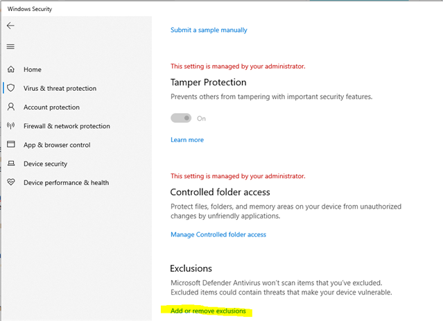

    One thing we noticed is that it's much faster to build on Linux compare to Windows. I guess due to some optimization with the compiler. In addition Windows' antivirus software is also causing the build to be slower. We noticed that if we put the nRF Connect folder into exclusion folder of Windows Security setting, the build can be done much faster.
    It's just our observation, it's your decision to choose to put the folder into exclusions list or not.
    You can also shorten the time of build by not building with -ns variant for development and switch to -ns after you are done with basic development. This can save the time to build TF-M. Same applied for building with MCUBoot.
  • Thanks for the reply. My Windows computer and the firewall are ruled by group policies, i dont have access to any settings.
