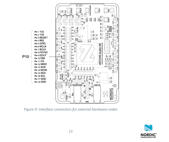

I am currently trying to integrate a digital microphone with the I2S peripheral of nRF5340 audio DK. I am accessing the P10 header of the nRF board for the particular I2S pins:
1) Pin 6-MCLK
2) Pin 7-BCLK
3) Pin 8-FSYNC
4) Pin 9-DOUT
5) Pin 10-DIN
The problem that I am facing is that I am not able to initialise the P10 header in my overlay file and I assume that is the reason I am not getting any readings.
Can I get some assitance regarding how to initialise the P10 headers in order to establish I2S communication between the microphone and nRF5340 audio DK.
Below is a code which defines the overlay file for a device which uses I2S interface.
In this code, I2S is being initialised on P5 of the nRF board.
I want to establish I2S communicaton similarly with P10 header of the board.

Interface connectors for external hardware codec
Parents Reply
    I have already completed the initialization step where P0.21 is set high to enable the P10 header, but I still don’t see any output on the I2S pins.
    Could you please help me understand how to initialize the pins for the P10 header in the board's overlay file? For the P5 header, I know the naming convention (for example, to use the MCLK pin, I refer to it as P0.12). What is the correct naming convention for using the I2S pins on the P10 header?
