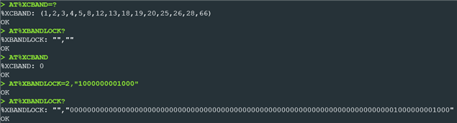

Then, I connected the 5G board to power. It was working perfectly since I received an email with the deviceID. I connected the 5G board to my laptop and typed the following command in Serial Terminal in nRF Connect for Desktop, and I got the following results. I also attached the screenshots in sequential order.
AT: 'OK', indicating command understood
AT%XCBAND: '%XCBAND: 12   OK', indicating that it is currently using band 12
AT%XCBAND=?: '%XCBAND: (1,2,3,4,5,8,12,13,18,19,20,25,26,28,66)   OK', indicating the available bands
AT+CGMR: 'mfw_nrf9160_1.3.6   OK', indicating the firmware version
AT%XBANDLOCK?: '%XBANDLOCK: "",""   OK', indicating no bands currently locked to

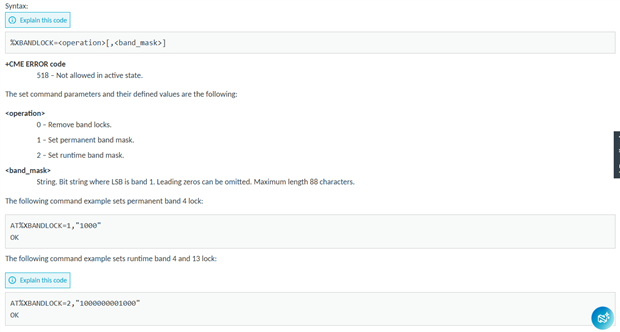

It looked like everything was working fine. Now I tried to lock the 5G board's LTE band of operation by using the %XBANDLOCK command provided here: Band lock %XBANDLOCK. However, if I tried their example commands in the Serial Terminal, the results were 'error' as shown below. Did anyone have this issue before? I really appreciate it if anyone could help me solve this.
