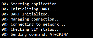

fanstel blg840F not sending at comment reply
I recently bought a fanstel blg840 device, and I have programmed At client firmware in nrf91 and custom code into nrf52, but the problem is nrf52 is sending at comments to the nrf9160, but it doesn't reply back? Do you have any idea of this?              this is my code

  • Hello Thanu,
    I'd like to ask some basic question initially just to be sure. Are you able to program both of these devices separately? They are powered up and code is running on them? Can you see for example that the stack pointer is moving?
    Q1: You are sending commands from the nRF52, are you sure they are sent in the expected way? Are you able to see the command activity with an oscillioscope?
    Q2: Are you getting or seeing any signal coming out of the nRF91 indicating that it is listening or rejecting incoming commands?
    Q3: It seems you have enabled RTT, is that on both the nRF52 and nRF91, what is it printing?
    Best regards
    Asbjørn
