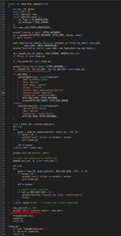

Reusing a single socket for multiple HTTPS requests (HTTPS client example) with nRF9160 DK over LTE connection
I was wondering how I can update my current code (see below) to reuse a single socket for multiple HTTPS requests, rather than opening and closing a socket for each HTTPS request. The code is a slightly modified version of the Nordic SDK HTTPS client sample code which can be found under /nrf/samples/net/https_client. It should be noted that I am using an nRF9160 DK over an LTE connection.
Alternatively, if there is any way to speed up the current code as it is taking me at least 3-4 seconds to run a single request.
Any help is appreciated.
main.c

static int send_http_request(void)
    int err, fd, bytes;
    size_t off = 0;
    struct addrinfo *res;
    struct addrinfo hints = {
        .ai_flags = AI_NUMERICSERV,
        .ai_socktype = SOCK_STREAM,
    char peer_addr[INET6_ADDRSTRLEN];
    printk("Looking up %s\n", HTTPS_HOSTNAME);
    err = getaddrinfo(HTTPS_HOSTNAME, HTTPS_PORT, &hints, &res);
    if (err) return;
    inet_ntop(res->ai_family, &((struct sockaddr_in *)(res->ai_addr))->sin_addr,
              peer_addr, INET6_ADDRSTRLEN);
    printk("Resolved %s (%s)\n", peer_addr, net_family2str(res->ai_family));
    fd = socket(res->ai_family, SOCK_STREAM, IPPROTO_TLS_1_2);
    if (fd == -1) goto clean_up;
    if (tls_setup(fd)) goto clean_up;
    printk("Connecting to %s\n", HTTPS_HOSTNAME);
    if (connect(fd, res->ai_addr, res->ai_addrlen)) goto clean_up;
    if (USE_POST) {
        snprintf(send_buf, sizeof(send_buf),
            "POST %s HTTP/1.1\r\n"
            "Host: %s\r\n"
            "User-Agent: slm\r\n"
            "Accept: */*\r\n"
            "Content-Type: application/json\r\n"
            "Content-Length: %zu\r\n"
            "Connection: close\r\n\r\n%s",
            HTTP_POST_PATH, HTTPS_HOSTNAME,
            strlen(HTTP_POST_BODY), HTTP_POST_BODY);
    } else {
            "GET %s HTTP/1.1\r\n"
            "Host: %s\r\n"
            "Connection: close\r\n\r\n",
            HTTP_GET_PATH, HTTPS_HOSTNAME);
    size_t total_len = strlen(send_buf);
    off = 0;
    do {
        bytes = send(fd, &send_buf[off], total_len - off, 0);
        if (bytes < 0) {
            printk("send() failed: errno=%d\n", errno);
            goto clean_up;
        off += bytes;
    } while (off < total_len);
    printk("Sent %d bytes\n", off);
    // clear the receive buffer before use
    memset(recv_buf, 0, sizeof(recv_buf));
    off = 0;
    do {
        bytes = recv(fd, &recv_buf[off], RECV_BUF_SIZE - off - 1, 0);
        if (bytes < 0) {
            printk("recv() failed: errno=%d\n", errno);
            goto clean_up;
        off += bytes;
        // prevent buffer overflow
        if (off >= RECV_BUF_SIZE - 1) {
            printk("Warning: response too large, truncating\n");
    } while (bytes != 0);  // 0 means peer closed connection
    recv_buf[off] = '\0';
    printk("\nFull response:\n%s\n", recv_buf);
    freeaddrinfo(res);
    close(fd);
    return 0;
clean_up:
    if (res) freeaddrinfo(res);
    if (fd >= 0) close(fd);
    return -1;
    Try to split the send_http_request function into different parts, for example like this. Then you just close the connection once you are done communicating.
    I think this is known as TCP Connection Pooling.
    Sigurd Hellesvik
  • Hi Sugurd,
    When using a single socket for multiple http requests I have been running into issues where the modem disconnects after one request is sent. I am using an Azure website and read somewhere that Azure automatically closes the connection after each request. Is this true? Is there anything I can do to surpass this? Alternatively is there any way of speeding up the current code as each request is taking 3-4 seconds to connect to the server.
    Thank you.
  • Hi Sugurd,
    Thank you.
