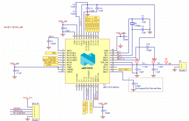

nrf52820 custom board

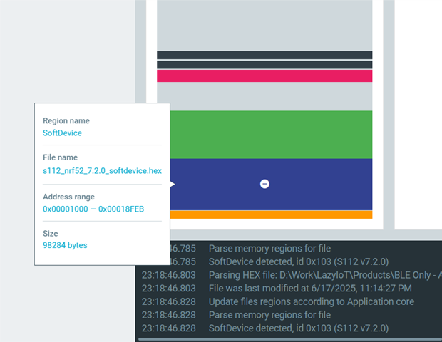

I tried to incorporate ble dfu to my application but the bootloader never finds the application, neither when hex files (of app + softdevice + bootloader + settings) are programmed via nrf programmer or hex files (softdevice + bootloader + settings) are programmed via nrf connect programmer and app is loaded via the nrf connect cell phone app. All i see is the DFUTarg being advertised and I have also confirmed it with RTT output.
I have attached the 4 relevant files here.
here is the command I used to generate settings:
nrfutil settings generate --family NRF52QFAB --application lazyiot_axis_nrf52820.hex --application-version 1 --bootloader-version 2 --bl-settings-version 2 settings.hex
and here is the screen shot of all the files loaded in nrf programmer:
Please provide guidance. This is the blocking issue before we start production.

  • Hi Hung,
    Here is the schematic. P0.16 is tied to ACC Int 2 pin which is disabled by default.
    What there anything in the files I shared that may be indicated any issue?
    I can try to take the motion sensor off the board and try. But is that the only thing? I could also disable the button option and test.
    Regards
    Noaman
  • Hi Noaman,
    Please double check which pin is assigned as NRF_BL_DFU_ENTER_METHOD_BUTTON_PIN in your code.
    Also please check the level of this pin in a normal application , it should be at VDD and not at GND. If it's at GND (0) then it will keep the bootloader to stay in DFU mode. See dfu_enter_check() in the nrf_bootloader.c file. If you don't plan to put the device to DFU mode via a pin, you would need to set NRF_BL_DFU_ENTER_METHOD_BUTTON to 0 in sdk_config.h of the bootloader.
