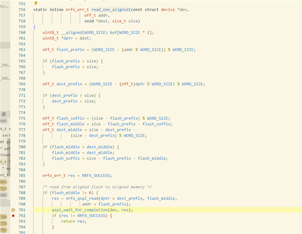

Facing an issue when we are trying to mount a file system on external flash(M95P42) + nrf52840.
We are developing an application on nrf52840 and wanted to use M95P32 as external flash.
used below .overlay configuration to enable it on zephyr.
&mx25r64 {
   compatible = "nordic,qspi-nor";
   status = "okay";
   sck-frequency = <8000000>;
   writeoc = "pp";
   jedec-id = [ 20 00 16  ];
   readoc = "read4o";
   ppsize-512;
   size = <33554432>;
   partitions {
      #address-cells = <1>;
      #size-cells = <1>;
      filesystem_partition2: partition@0 {
         status = "okay";
         label = "ext_fat_fs";
         reg = <0x00000000 0x00400000>; // 4MB for fat32
We attempted to mount an FS_FATFS filesystem, but the process is getting stuck at the fs_mount() function.
Found below details during the debug.
fs_mount function is waiting on a k_sem_take(), please find the function and file details below.
file path is :- C:\ncs\v2.6.1\zephyr\drivers\flash\nrf_qspi_nor.c
function name :- read_non_aligned()
screenshot:-
please help me to resolve this, let me know if you need more details.
