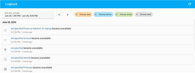

Issue with using nRF7002 DK with Matter "Light Bulb Matter" example
I am working with the nRF7002 DK board and attempting to use the "Light Bulb Matter" example from Zephyr. I am encountering issues when trying to connect the board to Wi-Fi using my Google Pixel 8a smartphone and the Home Assistant app. Although I encounter non-blocking errors, the initial connection seems to work.
First, I provision the Wi-Fi via BLE to the board, and everything appears to be functioning correctly except for one error on the COM port:

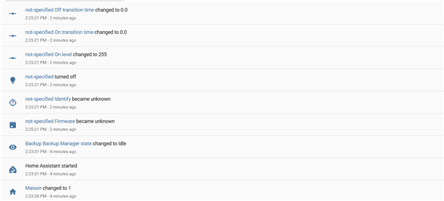

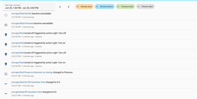

Here is the error I encounter:
  • IPV6_PKTINFO failed: 109
Despite this error, the nRF7002 DK successfully connects to the Wi-Fi. After that, Home Assistant on my smartphone allows me to connect the "Matter device," which I do. However, the system only works for about thirty seconds before the device is marked as "unavailable" in the Home Assistant app. I am unable to turn the lamp on or off. Home Assistant tries to communicate with the board but encounters repeated errors.
My Home Assistant server is running on a Linux virtual machine.
Could you clarify the correct procedure for using the "Light Bulb Matter" example with the nRF7002 DK board and Home Assistant, please?
Thank you very much for your help!

  • Germain B said:
    Here is the log from Home Assistant
    I was thinking of the log you find in Settings -> System -> Logs, from the time around when you tried to set up the bulb. Can you send that as well?
    BR,
    Edvin
  • Oh, yes sorry. Here are my logs. (Surprisingly, today the bulb worked for several minutes before stopping working fine.) :

    Well, the timeouts are probably because HA can't reach the bulb.
    Someone from our Matter team looked at the HA logs, and said:
    "The logs show that the device was correctly commissioned over BLE, then has been connected to the Wi-Fi network, on which it received Commissioning Complete command over Wi-Fi (CASE session)
    Then there is no more logs. At this point the Controller (Home Assistant in this case) should start Matter Subscription to learn the capabilities of the accessory, but it doesn not happen. As the CASE session has been established, this is more likely related with the AP. Is there any more logs from the Accessory (the DK/light bulb)?
    We have no experience with Home Assistant - however, for me it looks like the problem is related to lack of communication from the controller side, either due to routing issues, or Home Asssistance configuration."
    Do you have any other Matter devices on your network? Do they work as expected?
    Edvin
