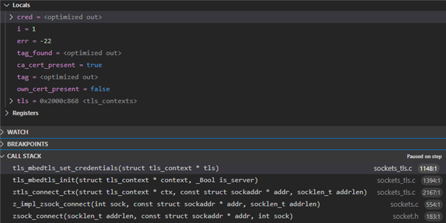

Now with this config when I replace Amazon Root CA 1 and 3 by the 2 and 4, I always get a -22 error on the socket opening.
The examples I found in the DevAcademy uses Amazon Root CA 1 and I did not found any document explaining how to make it work with certificate using "sha384WithRSAEncryption" like amazon root CA 2 and "ecdsa-with-SHA384" like Amazon root CA 4.
I have tried playing with different setting in the .conf with no success...
Is there any kConfig combination that is recommended, an example or a documentation that could help us with this issue ?
For information, credentials are added using "tls_credential_add", certificate are converted from .pem to const uint8_t * see attached files

    I dived deeper in the code to see where the error comes from, the -22 error is thrown by "tls_mbedtls_set_credentials"
    Hope this helps, please tell me if you need more information.
