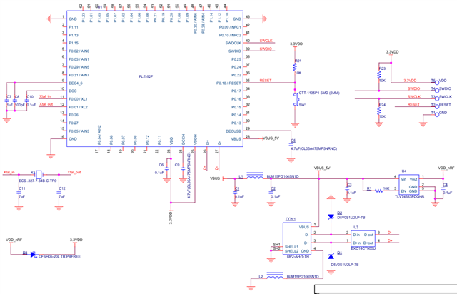

[nRF52840 USB Dongle] Irregular Notification Intervals from nRF52832 Peripheral (Expected 7.5ms, Observed 0–40ms)
I'm currently developing a USB dongle using the nRF52840, and I'm facing an issue with inconsistent data reception intervals. I’d appreciate your insights on this problem.
The peripheral device I'm connecting to is an nRF52832, which transmits data periodically with a minimum interval of 7.5ms.
When I use tools like nRF Toolbox or nRF Connect for Desktop, I see stable and consistent intervals of around 7–8ms, as expected.
However, when using my own custom firmware/code, the notification intervals become highly irregular, ranging anywhere between 0ms and 40ms. I was expecting consistent intervals like 7.5ms or possibly multiples like 15ms, but that’s not the case.

Is there something I might be overlooking when programming the Bluetooth receiver side on the nRF52840?
Any suggestions or pointers would be greatly appreciated.

  • Try to measure time on the receiving device and not on the PC. Windows timing can be interesting. See also timeBeginPeriod().
    I also recommend putting an USB 2.0 (or higher) hub between the PC host and the NRF device.
