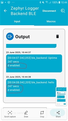

In our development using NCS-2.6.1 it is desirable to have logs using BT NUS.
"Serial Bluetooth Terminal" android application is used. Logs are having corruption.
Looks like remains of longer message is spilled out to following shorter messages.
Same behaviour shows sample application ble_backend. To show issue better the ble_backend application while loop part modified to
static int c = 0;
while (1) {
uint32_t uptime_secs = k_uptime_get_32()/1000U;
if ( c == 0)
LOG_INF("hello");
else
LOG_INF("Uptime %d secs", uptime_secs,c);
c = (c+1) % 2;
k_sleep(K_MSEC(1000));
in such case output is
[00:00:00.818,939] ble_backend: BLE Logger Backend enabled.
[00:00:01.005,340] ble_backend: Uptime 1 secs
end enabled.
[00:00:02.005,493] ble_backend: hello
1 secs
end enabled.
[00:00:03.005,645] ble_backend: Uptime 3 secs
end enabled.
[00:00:04.005,798] ble_backend: hello
3 secs
end enabled.
[00:00:05.005,950] ble_backend: Uptime 5 secs
end enabled.
[00:00:06.006,103] ble_backend: hello
5 secs
end enabled.
