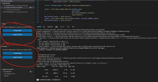

Why did the build succeed, but these projects are not showing up in the tool?
Hi Grandpa,
We have a similar ticket here: RE: Always "The build configuration is stale. Run a pristine build" in newer versions of nrf connect for vs code
Could you check the solution from Kazi ? Please try to install toolchain using VS Code.
Yes, thank you. The reason is that NRF Connect for VS Code was updated to the latest version, but other toolchains like Python and West were not.
