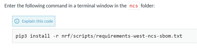

I've been following the instructions here: Software Bill of Materials
In order to run pip, I first had to install Python for Windows.  Was this a mistake or unnecessary?  Is there a version of pip included somewhere in the SDK that I should have used?
Having installed Python, I then ran the above command from the \ncs\v3.0.0 folder.  This installed jinja2 and MarkupSafe but did not install the scancode-toolkit because "markers 'platform_machine == "x86_64"' don't match your environment" (even though I am on a 64bit Windows platform).

  • Update 2: I reverted to an earlier version of Python (v3.12 instead of v3.13) and that let me install the scancode-toolkit manually.

    This was a necessary step. The SDK’s bundled Python is not directly exposed for pip installs outside the managed environment.
    The SBOM tool uses Scancode-Toolkit, which can have platform-specific requirements. The error about 'platform_machine == "x86_64"' suggests a mismatch between your Python environment and the expected platform. This is likely why you were getting errors after manually installing the scancode-toolkit. Make sure you are using a 64-bit version of Python on a 64-bit Windows system.
