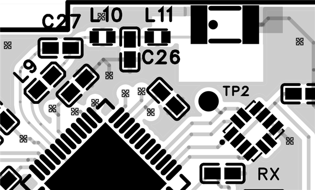

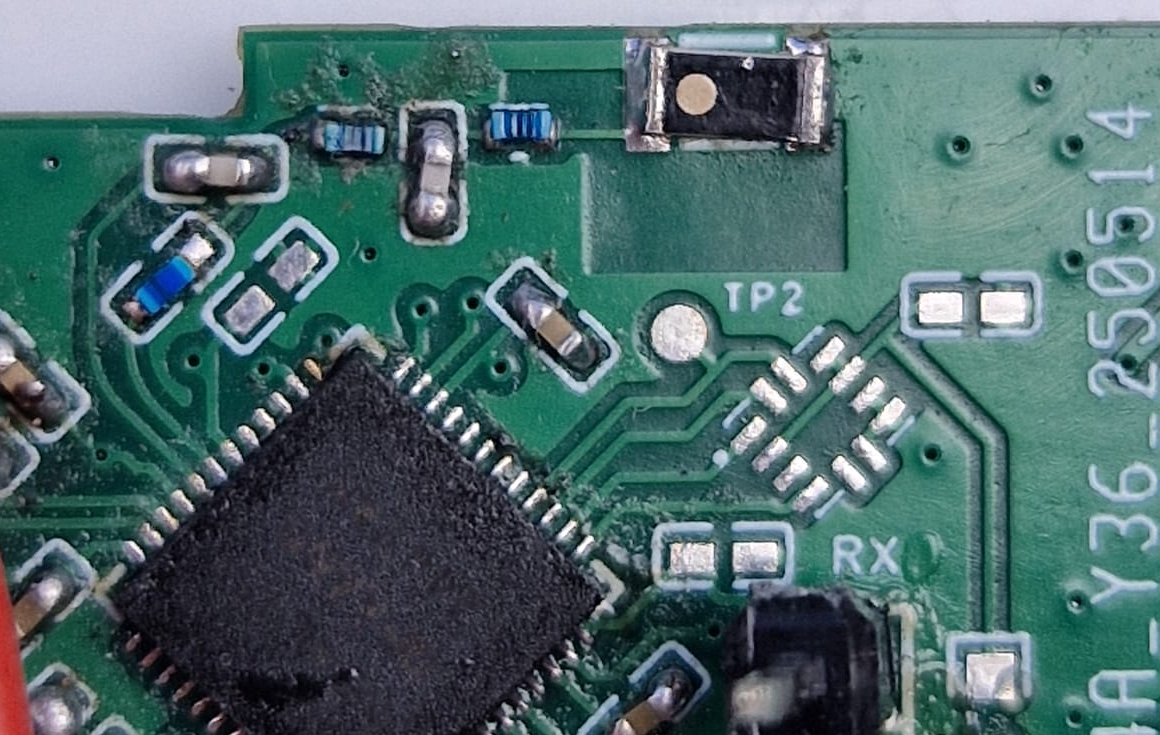

My HW board:
Thank you for any help.
Jan.
    The board might give some issues, yes. Please create a private ticket with schematics and gerber files, for our review.
