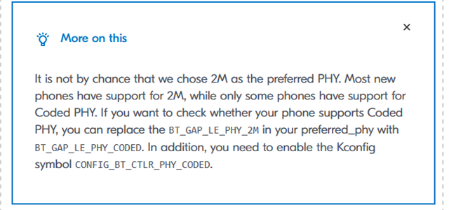

I've confirmed my phone is able to use coded phy (samsung galaxy s10) based on internet searches so this shouldn't be the issue.  But there's a note in the lesson here:
I replaced BT_GAP_LE_PHY_2M with BT_GAP_LE_PHY_CODED as described, and then in prj.conf I added
CONFIG_BT_CTLR_PHY_CODED=y
which is what I assume that note is telling me to do.
