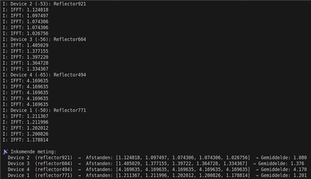

my name is Nick De Leenheer, and i am finishing my thesis on indoor localisation with CHANNEL SOUNDING. i currently got these outputs in my venv using SERIAL:
so i use the ranging data from 4 different devices, and then i use this multilateration algorithm:

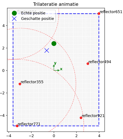

afterwards, i want to plot 4 ranging circles from the 4 reflector (beacons) to estimate the location of the tag...
But this plt.show() in my code doesnt work iteratively... so i am wondering what would work best to update and show my plot. Captured data i was able to plot in an animation with animate from matplotlib. But now i don't know what would work on my LINUX computer.
