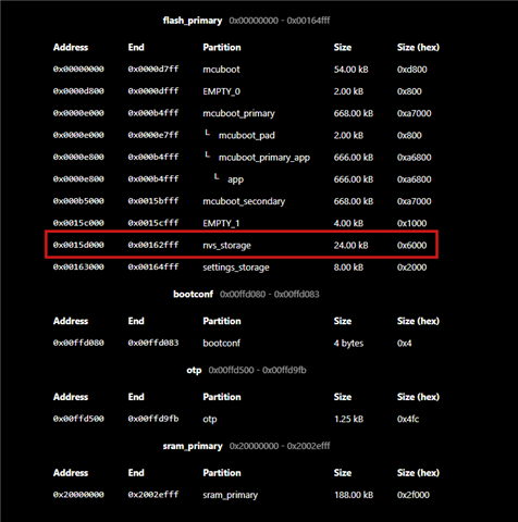

Revised the flash memory allocation for reserve and extend the nvs storage partition
I would like to use nvs to leave a space for store usage data.
Below is the current memory map of my program, however, the nvs storage was be lmited at 24kB.
However, I would like to modify the memory setting as below:
# Address:     Size:       Name:
# 0x00000000   0x0000D800  mcuboot
# 0x0000D800   0x00000800  mcuboot_pad
# 0x0000E000   0x0009A000  app
# 0x000A8000   0x0009A000  mcuboot_secondary
# 0x00142000   0x00026000  storage_partition (150 KB)
# 0x00168000   0x00002000  settings_storage
# (Remaining 8 KB left unassigned, optional)
mcuboot:
  address: 0x00000000
mcuboot_pad:
  address: 0x0000D800
app:
  address: 0x0000E000
  size: 0x9A000  # 624 KB
mcuboot_secondary:
  address: 0x000A8000
storage_partition: #nvs storage
  address: 0x00142000
  size: 0x26000  # 150 KB
settings_storage:
  address: 0x00168000
  size: 0x2000  # 8 KB
Is that possible for you to guide me how to do the modification for this set up? And which file I should add or modified for it?
