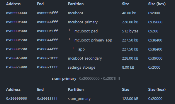

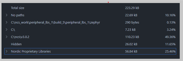

there is my project rom size in memory report , I would like to asking what is the "NO Paths" item and hidden item
 they hold my 20% ROM size. and what is the content in Nordic Proprietary Libraries. it also take 25% rom size.
since I need to add a new storage zone (around 16kB) for data storage, but my rom size is almost full by library and stack ,
I cannot reduce the image size , How can I reduce the libraries size and the stack size. ?
  • Its the stuff (softdevice controller) that actually runs the BTLE radio.
    Your estimated 25% of about 200KB sounds correct to me when running peripherial mode (central/multirole would fill up the entire partition).
    Consider a redesign: Either use external flash for the firmware update or the bigger NRF52840 chip with twice the internal flash.
