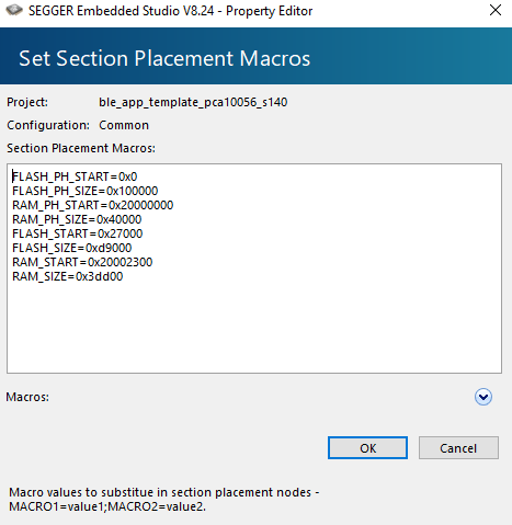

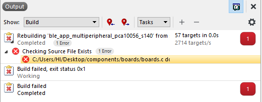

  • Whenever I tried to build the multi-peri example, it errors out the following:
    , while my directory path looks like this: C:\Users\HI\Desktop\nrf52840\nRF5_SDK_17.1.0_ddde560\components
    I tried manually including path but then it throws out an error for almost every file (Error: Source file doesn't exist)
    So I tried to copy pasted the required snippets onto my main project, this(Error: Source file doesn't exist) wasn't thrown, however I am unable to connect my dongle as a peripheral to multiple android phones.
    Placement macros:
    Code:

    Can you build any other example ?
    Could you show where the example is placed ?
    Please try to put the SDK to a shorter path. For example at C:\nRF5_SDK . I suspect that the path was too long.
