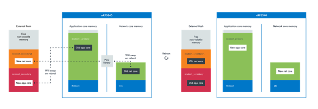

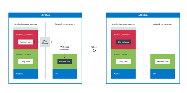

    Would maintaining a partition in external flash be sufficient for rollback use when performing non-simultaneous updates? Or would the backup image need to be stored in the network core's internal flash?
    For example, if two separate partitions are maintained in external flash (one for the application core's secondary image and one for the network core's secondary image), and an update for just the network core gets triggered, would the network core's old firmware be swapped into external flash? Or would it be discarded?
    I only ask because in rereading the DevAcademy lesson on DFU for the nRF5340, I was under the impression that the old image for the network core could remain available via the swap mechanism shown in this photo for non-simultaneous updates:
    and this photo for simultaneous updates:
    But with the information you've provided, I'm assuming these photos are simply to illustrate the swap mechanism for firmware upgrades, and the same mechanism doesn't apply for downgrades/rollbacks?

    The application core writes directly to the netcore's flash using IPC or shared memory (PCD RAM). So, when you update only the netcore, the old firmware gets overwritten and is no longer available.
    This is the default behavior, and currently, netcore rollback is not officially supported. You can check the old DevZone thread I shared earlier for more details.
    Also, take a look at this repository,  the examples are a bit outdated, but they show how shared SRAM is used. The images you mentioned show the swap mechanism in action.
    I think this is how a netcore rollback might be possible, but it hasn’t been officially tested or supported by Nordic. So I can't say for sure if it will work, and I won’t be able to provide much support, as I haven’t tried it myself.
