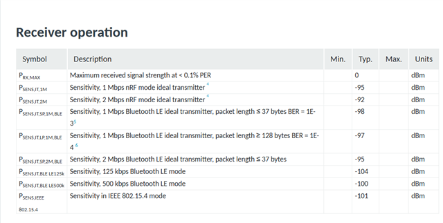

I’m working with the nRF5340 and nRF21540 for 802.15.4 and would like to know:
  1. The expected RX sensitivity estimation for this combination.
  2. Any reference measurement values available.
Any information you can provide would be really helpful.
Thanks!
    We have data for Received signal strength of nRF5340.
    source:RADIO — 2.4 GHz radio
    These values are from the nRF5340 Product Specification and represent typical performance for the SoC alone, without the nRF21540 front-end module (FEM) attached.
    ''So far, I’m getting -105 dBm, but I think it can be better.'' So, if you see -105dBm, it's an improvement after attaching FEM.
    However, the product specification does not provide a combined reference value for nRF5340 + nRF21540, as the final performance depends on board design, antenna matching, and configuration in the application.
