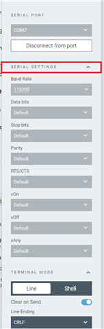

    Please send me a screenshot of the Serial Settings on the Serial Terminal application in nRF Connect for Desktop, like below:

    For Toolchain and SDK Manager v2.8.0:
    nRF Connect for Desktop Terminal: It is working. Everything is okay
    VS CODE Terminal: Not Ok - I don't see messages. If possible, try to help me.

  • Hi:
    VS Code Terminal is working. I receive messages from Nrf52 DK.

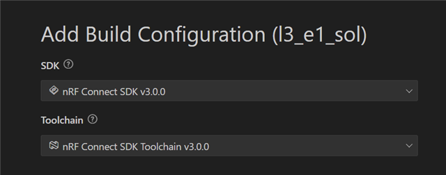

    1. This seems to be an issue with your toolchain. Make sure you are selecting the same SDK and toolchain version when adding the build configuration.
    You could also try uninstalling the v3.0.0 and v2.9.0 toolchains and installing them again.

    I used the same version in SDK and toolchain..
    About You could also try uninstalling the v3.0.0 and v2.9.0 toolchains and installing them again.: I did that.

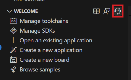

    In addition, please press on this icon next to the WELCOME window in VS Code, save the file that is generated and attach it in your next reply as well.
