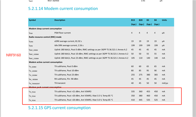

Hi nordic: What is the peak current of NRF9151? The relevant parameter cannot be found in the datasheet, while it is available for NRF9160.
Best Regards
JERMI.JIN

Hi JERMI.JIN,
Note that the terminology has changed from nRF9160 to nRF91x1 to better explain what is represented. This note describes the change:
The term average TX current consumption for nRF9151 corresponds to peak current consumption used in nRF9160 Product Specification. Both terms refer to average current consumption during TX subframe.
The relevant tables for nRF9151 can be found in the VDD current consumption part of the nRF9151 Hardware Design Guidelines.
Maria
