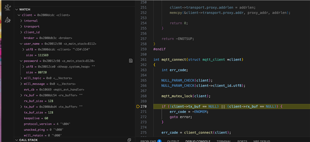

  • I started to debug mqtt_connect this morning and have found that the -12 seems to be coming from connect_request_encode line 832 which is pack_utf8_str(client->username, buf).
    The few other posts I have read seem also to be related to problems with the username / password structures.
    Any thoughts?
  • I just took another look this morning and see now that the password first and then the username appear to be becoming corrupted with the first line of the mqtt_mutex_lock call at line 268 of mqtt.c.  I ran the debugger several times and got consistent results.  If this is correct, the mqtt_client struct is corrupted prior to entering client_connect.
    Please could someone confirm if this is in fact the case?

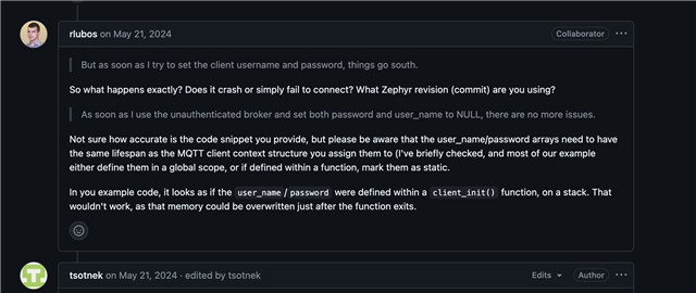

  • And finally, I have the answer.  I eventually found this link : https://github.com/zephyrproject-rtos/zephyr/issues/73089 with this comment revealing the cause of the problem.
    There are multiple ways to assign the username and password and most will compile, but fail at runtime.  The final solution for me was to declare the mqtt_utf structs as static in main.c and then pass them as pointers to client_init.  It then took several attempts to find a working solution to assigning the values to the structs.  The final version looks like this:
