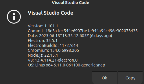

I tried several vs code version and nrf connect plugin versions. Im now on v2025.5.152 of the nrf connect for vs code.
And the following vs code version:

    I am not actively using bsim, but ncs/zehpyr is using it I guess. It started after installing a new toolchain v2.9.2 of ncs through the manage toolchains option in the nrf connect plugin of vs code.
    Now every time I interact with the nrf connect plugin it spams this error for like 8-10 times. So if i click on a build configuration the error is thrown in the output window for 8-10 times. Then if i start a build, again the error is thrown for couple of times. The build does complete like normal, however when it finishes the output window again pops-up and shows the error is thrown again for x times.
    The error suggests that to fix it you run "west update", but this doesnt fix the issue. West update works and doesnt give any error. But then if I interact with the nrf connect plugin then the output window starts throwing errors again.

  • There is nothing interesting to see in the west update. Just that everything updated just fine. However, VSCode stopped spamming the error, so it seems solved now. No clue what has changed.
