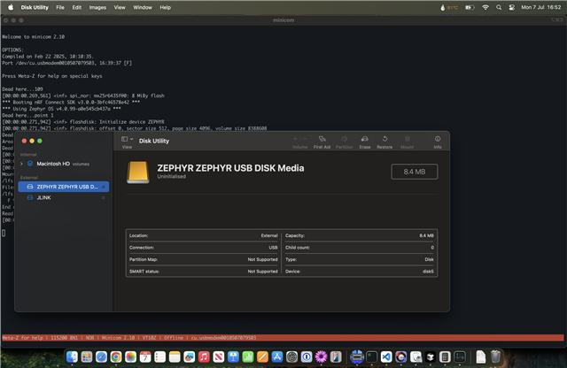

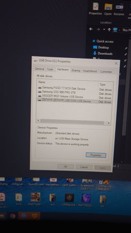

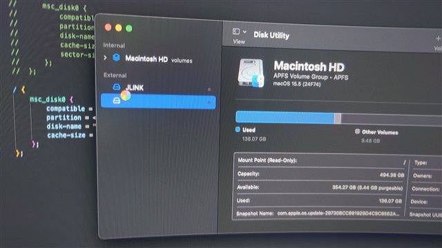

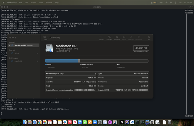

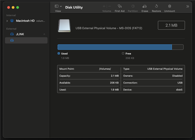

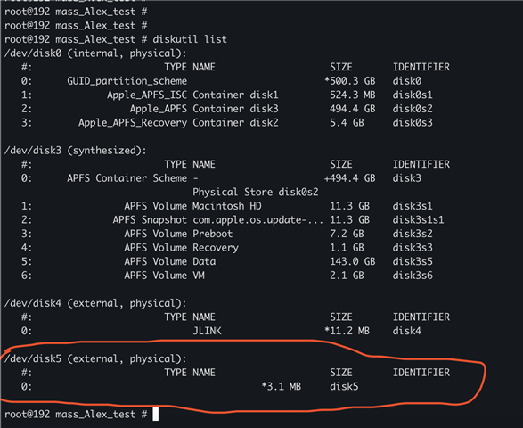

Hello everyone,
As the title suggests, we're trying to get the on board flash (mx25r64 as far as I can tell) of the nrf7002dk devboard working as a USB mass storage device (should be visible when connecting to Windows and MacOS).
Doing a bit of googling, I've found that a good starting point is the sample from:
/opt/nordic/ncs/v3.0.0/zephyr/samples/subsys/usb/mass/
I started from there and tried various bits and pieces from different posts in the Nordic DevZone to try and get it working. Sadly it doesn't wanna yield and the most common error is either the partition manager not recognising the label put in the overlay or something else related to the partition manager not accepting/ initialising the disk.
Latest build log:
root@Tudors-MacBook mass # west build -b nrf7002dk/nrf5340/cpuapp/ns --pristine

    But still that generated no positive result:
    [00:00:00.439,331] <inf> spi_nor: mx25r6435f@0: 8 MiBy flash
    *** Booting nRF Connect SDK v3.0.0-3bfc46578e42 ***
    *** Using Zephyr OS v4.0.99-a0e545cb437a ***
    [00:00:00.441,711] <inf> flashdisk: Initialize device ZEPHYR
    [00:00:00.441,711] <inf> flashdisk: offset 0, sector size 512, page size 4096, volume size 8388608
    Area 6 at 0xfc000 on flash-controller@39000 for 8192 bytes
    [00:00:00.445,343] <err> fs: fs mount error (-5)
    [00:00:00.445,343] <err> main: Failed to mount filesystem
    [00:00:00.445,587] <inf> main: The device is put in USB mass storage mode.
    The disk exposed towards MacOS is just like the disk created with LittleFS: disk is 8Mb, visible, inaccessible, unformattable, and Zephyr is still pointing towards the internal memory.

  • After some more testing, here are some conclusions of the current state of things:

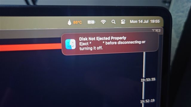

    FAT FS seems to work on Windows but crashes HORRIBLY on MacOS. Board bootup log (note, this is after I connected it to a Windows machine and created a text file on it named AAA.txt):
    I'm using the Disk Utility App to check if MacOS detects the mass storage. Disk Utility freezes, then it forcefully ejects the Zephyr storage (which it sees as "     ") and somehow formats it.
    I also tried using a bash command: diskutil list. But the behaviour is the same: terminal does nothing for ~20 seconds and then lists all disks except the Zephyr disk (again ejecting and formatting the disk).

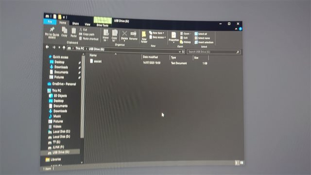

    On the Windows side: the drive mounts up, you can create a file and save data to it, you can eject it/ power off the board and upon power on the file is still there:
    This morning I decided to dig deeper on the Windows side since the board logs show that the internal flash is still used. So I decided to try and put a 2.1 MB image on the drive:
    Windows popped up the "Copying" window, it thought for a few seconds, then closed it and forcefully ejected the drive. I restarted the board and the text file that I created was there together with the picture that I tried copying. So I tried copying the picture back to my drive to check if it was correctly stored. This is the picture that I got from the drive:
    The name and size are the same as the original image, but the actual data inside the file is corrupted/ inacessible. -> most likely just metadata about the file was copied (name, size, date created, etc.), but the contents themselves weren't since they wouldn't fit in the internal flash.

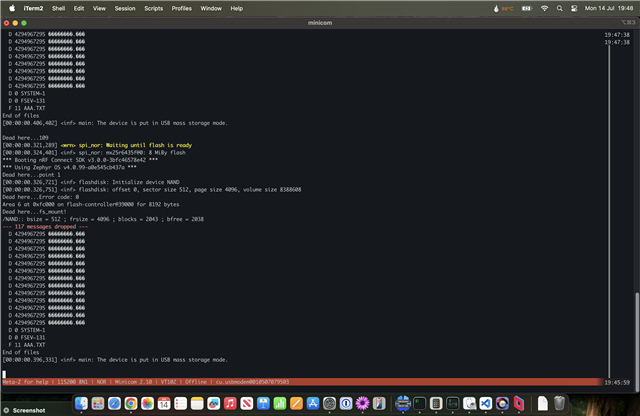

    I opened the serial port for COM4 to see what're the board's logs:
    Serial port COM4 opened
    [00:00:00.322,021] [1;33m<wrn> spi_nor: Waiting until flash is ready[0m
    [00:00:00.324,401] [0m<inf> spi_nor: mx25r6435f@0: 8 MiBy flash[0m
    [00:00:00.326,721] [0m<inf> flashdisk: Initialize device NAND[0m
    [00:00:00.326,751] [0m<inf> flashdisk: offset 0, sector size 512, page size 4096, volume size 8388608[0m
    /NAND:: bsize = 512 ; frsize = 4096 ; blocks = 2043 ; bfree = 1499
    [1;31m--- 353 messages dropped ---
    [0m  D 4294967295 ÿÿÿÿ.ÿ{FF}
    [1;31m--- 20 messages dropped ---
      D 0 FSEV~384
      D 0 SYSTEM~1
      F 19 AAA.TXT
    End of files
    [00:00:00.414,947] [0m<inf> main: The device is put in USB mass storage mode.
    [0m
    [00:00:01.053,253] [1;31m<err> usb_msc: LBA out of range[0m
    [00:00:01.522,308] [1;31m<err> usb_msc: LBA out of range[0m
    Serial port COM4 closed
    So, although it KINDA works on Windows, unless I see "Area 4 at 0x0 on MX25R64 for" in the board's bootup logs, the external flash isn't used for USB mass storage.

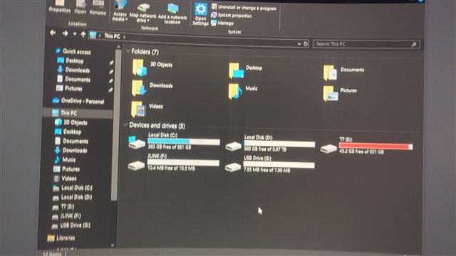

  • After a few tries, Alexander Rawstone managed to get a FAT FS usb mass storage sample going.
    The sample provided by him: 1884.mass.zip
    It works flawlessly with files, folders and is recognised by both MacOS and Windows.
    I played around with it a bit and found some interesting points:
    - when connecting it to Windows, if you copy a file to it and then decide to delete it, the file doesn't go to the computer's Recycle Bin, but rather a hidden folder is created that's named ".Trashed". To truly delete the file; you must delete it from inside the .Trashed folder. Is this a bug or a feature?
    - if you restart/ power on your Windows machine and left the usb mass storage connected, the explorer.exe process doesn't start correctly (after login, a black screen is presented, not the desktop) until you unplug the devkit (then the desktop appears).
    - whatever I do, I can't get it to expose the full 8MB of flash as a mass storage. I tried modifying the related register in the overlay file into: reg = <0x00000000 0x00800000>; but to no effect. I also tried "nrfjprog --eraseall" and "nrfjprog --recover" but whatever I do, the usb mass storage created is always 2MB in size.
