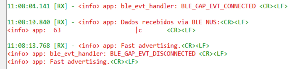

my nus_data_handler funcion:
        NRF_LOG_INFO("Dados recebidos via BLE NUS:");
        NRF_LOG_HEXDUMP_INFO(p_evt->params.rx_data.p_data, p_evt->params.rx_data.length);
        nus_Uart_control = p_evt->params.rx_data.p_data[0];
        if (nus_Uart_control == 'z' || nus_Uart_control == 'y')

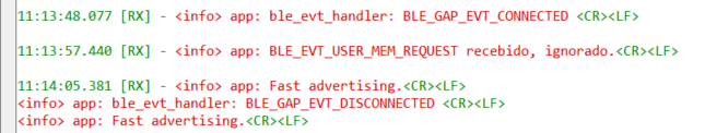

        case BLE_EVT_USER_MEM_REQUEST:
            NRF_LOG_INFO("BLE_EVT_USER_MEM_REQUEST recebido, ignorado.");

if I send one letter "c", the result works:
But if I sent my string "z0,73,137,197,529;0.0,5.02,9.51,13.54,35.50" is ignored.
Anyone can help me to solve it?
