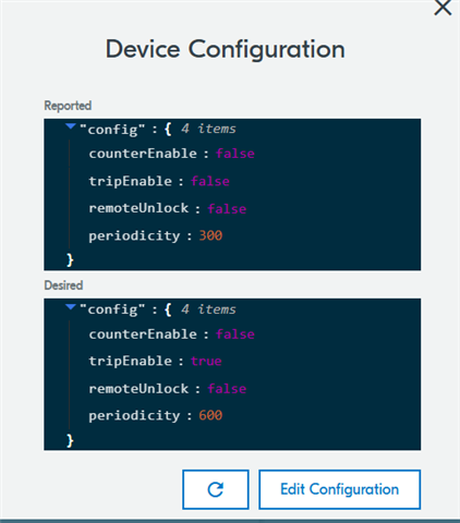

  1. What could cause CoAP 4.06 Not Acceptable specifically for shadow delta requests while all other operations remain functional?
  2. Has there been any recent change to nRF Cloud CoAP shadow service regarding Accept or Content-Format options?
  3. Could an invalid shadow document cause this persistent rejection? If so, what is the recommended approach to sanitise or reset shadow state without deleting and re-adding the device?
  • This is my configuration

    [00:01:39.904,571] <err> shadow_support_coap: Failed to request shadow delta: 134
    [00:01:49.904,724] <inf> shadow_support_coap: Checking for shadow delta...
    +CSCON: 0
    +CSCON: 1
    [00:01:51.454,956] <err> nrf_cloud_coap: Unexpected result code: 4.06
    [00:01:51.454,986] <err> shadow_support_coap: Failed to request shadow delta: 134
    [00:02:01.455,139] <inf> shadow_support_coap: Checking for shadow delta...
    +CSCON: 0
    +CSCON: 1
    [00:02:02.944,396] <err> nrf_cloud_coap: Unexpected result code: 4.06
    [00:02:02.944,396] <err> shadow_support_coap: Failed to request shadow delta: 134
    [00:02:12.944,549] <inf> shadow_support_coap: Checking for shadow delta...
    +CSCON: 0
    +CSCON: 1
    [00:02:14.491,821] <err> nrf_cloud_coap: Unexpected result code: 4.06
    [00:02:14.491,851] <err> shadow_support_coap: Failed to request shadow delta: 134
    [00:02:24.491,973] <inf> shadow_support_coap: Checking for shadow delta...
    +CSCON: 0
    +CSCON: 1
    [00:02:25.985,229] <err> nrf_cloud_coap: Unexpected result code: 4.06
    [00:02:25.985,229] <err> shadow_support_coap: Failed to request shadow delta: 134
