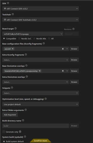

Here is my build option:
Any ideas for what reason might result in this build error?

  • Hi Justin,
    Looks like the default sample and default board then? That is strange. Are you seeing this also with other samples? If a basic sample doesn't build, my first assumption is that there something wrong with SDK installation - so nothing builds.
    Elfving

  • Ah, then I assume the issue is related to the Windows path length. You see windows has this max path length thing, and the name of the channel sounding samples are so long that it likely strikes out on these particular samples and not others.
    Could you try either shortening your path length, or what is probably the easiest: give the project a shorter name than the default sample name?
    Elfving
