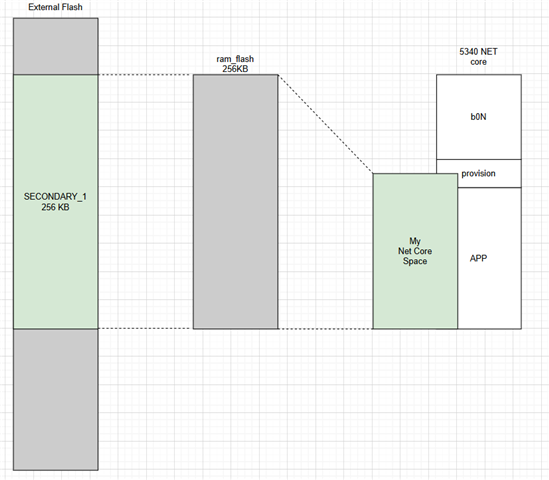

  • We have custom header for image verification in case of OTA.
  • I am afraid this cannot work without changing b0n. The start address of the network core image is used in b0n to both transfer the image over PCD and also to boot. This address is automatically extract from the build system.
    To do what you need, you need to not only change b0n but also dive into the build system and change it.
    Meanwhile, there are already validation mechanisms in b0n and MCUboot. Are they insufficient for you?
  • Attached build directory 'build.zip".
    CONFIG_PM_PARTITION_SIZE_PROVISION=0x1000 helps to make PM_APP_ADDRESS aligned with 0x1009800 as PM_APP_ADDRESS needs 2KB alignment.
    Thus provision is ending at #define PM_PROVISION_END_ADDRESS 0x1009800.
    Please note that, I am trying to use 0x1009000 - 0x1040000 space for HCI_IPC Net core application. There is a overlapping between PROVISION and NET_APP of 2KB (0x1009000-0x1009800).
    This 2KB (0x1009000-0x1009800) is used for custom header of NET_APP.
    Thus I am able to use...
    0x1000000 - 0x1008800 :  b0N          (34 KB)
    0x1008800 - 0x1009800 :  provision  (04 KB = 02 KB + 2KB(overlap))
    0x1009000 - 0x1009800 :  Custom header of NET_APP (2KB) , Part of FOTA image
    0x1009800 - 0x1040000:  NET APP  (218 KB)

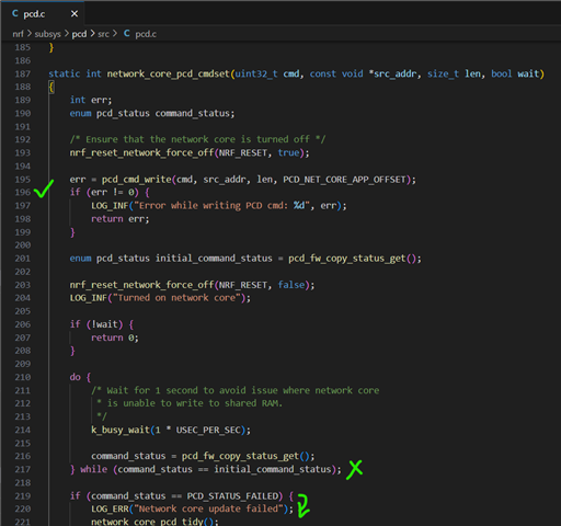

    Observation
    Currently command_status = PCD_STATUS_FAILED and failing NET core upgrade process.
    Questions
    1. In PM_Static.yml file, mcuboot_primary_1 represents  flash_simulators and represents NET Core flash. As per attached diagram, Does NET_APP image presents in secondary will get copied into Net core internal flash.
    mcuboot_primary_1:
      address: 0x0
      device: flash_ctrl
      end_address: 0x40000
      region: ram_flash

    Observation
