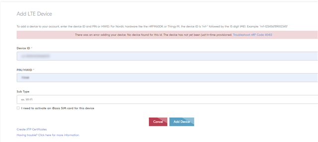

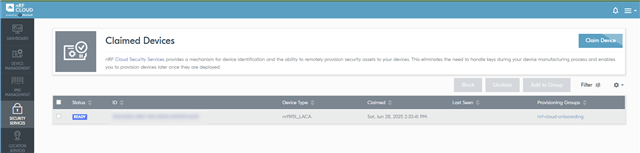

just passed Cellular IoT Fundamentals while I was waiting for my nrf9151dk to be delivered... Now that I have the DK I can't get the dk to be provisioned...
I couldn't get Lesson 1, Exercise 1 to properly "Add Device" in nrfCloud so I tried following this Nordic video: https://www.youtube.com/watch?v=roG7d-VftoM&t=4947s

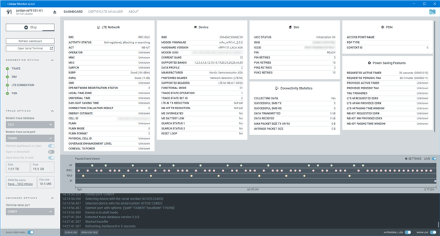

I can't get the device provisioned and I am not getting Operator, MNC, etc information. I am using the Onomondo sim

[00:00:12.372,589] <wrn> lte_lc: Registration rejected, EMM cause: 11, Cell ID: 180616208, Tracking area: 13326, LTE mode: 7
[00:00:13.722,442] <wrn> lte_lc: Registration rejected, EMM cause: 17, Cell ID: 75216151, Tracking area: 34064, LTE mode: 7
[00:00:25.625,488] <wrn> lte_lc: Registration rejected, EMM cause: 17, Cell ID: 72213526, Tracking area: 34067, LTE mode: 7
[00:00:37.043,182] <wrn> lte_lc: Registration rejected, EMM cause: 17, Cell ID: 75216151, Tracking area: 34064, LTE mode: 7
[00:00:39.014,495] <wrn> lte_lc: Registration rejected, EMM cause: 17, Cell ID: 37800450, Tracking area: 37632, LTE mode: 7
[00:01:25.550,445] <wrn> lte_lc: Registration rejected, EMM cause: 17, Cell ID: 180616208, Tracking area: 13326, LTE mode: 7
[00:04:10.610,137] <wrn> lte_lc: Registration rejected, EMM cause: 17, Cell ID: 75216331, Tracking area: 62190, LTE mode: 9
[00:04:55.971,527] <wrn> lte_lc: Registration rejected, EMM cause: 15, Cell ID: 37800468, Tracking area: 37760, LTE mode: 9
[00:05:01.726,898] <wrn> lte_lc: Registration rejected, EMM cause: 17, Cell ID: 180634682, Tracking area: 13647, LTE mode: 9
[00:05:47.669,494] <wrn> lte_lc: Registration rejected, EMM cause: 17, Cell ID: 180618810, Tracking area: 13649, LTE mode: 9
