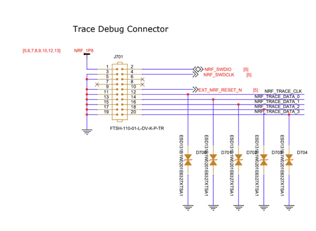

[LOMA] Hardware tracing doesn't work
Can Nordic share specific instructions on how to enable hardware tracing?
I've received the following patch from Tomasz, however I still see "trace clock missing" in Ozone.
&tddconf {
status = "okay";
tpiusources = <(NRF_TDDCONF_SOURCE_ETMMAINCORE)>;
portconfig = <0>;
Our trace port design hw is below:
