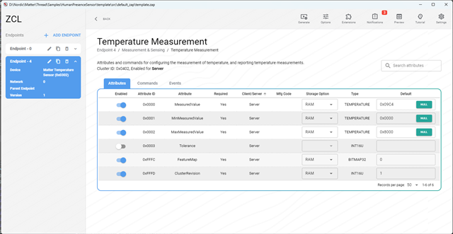

the zcl error
CHIP_ERROR AppTask::Init()
	/* Initialize Matter stack */
	ReturnErrorOnFailure(Nrf::Matter::PrepareServer(Nrf::Matter::InitData{	.mPreServerInitClbk = [] {
		CHIP_ERROR err = ReportSensorManager::Instance().Init();
		if(err != CHIP_NO_ERROR) {
			LOG_ERR("ReportSensorManager Init fial");
			return err;
	if (!Nrf::GetBoard().Init()) {
		LOG_ERR("User interface initialization failed.");
		return CHIP_ERROR_INCORRECT_STATE;
	/* Register Matter event handler that controls the connectivity status LED based on the captured Matter network
	 * state. */
	ReturnErrorOnFailure(Nrf::Matter::RegisterEventHandler(Nrf::Board::DefaultMatterEventHandler, 0));
	return Nrf::Matter::StartServer();
CHIP_ERROR ReportSensorManager::Init()
	k_timer_init(&sSensorTimer, &ReportSensorManager::TimerEventHandler, nullptr);
	k_timer_start(&sSensorTimer, K_MSEC(kSensorTimerPeriodMs), K_MSEC(kSensorTimerPeriodMs));
	/* Workaround: Default null values are not correctly propagated from the zap file. Set it manually to make sure
	 * the starting value is cleared. */
	 // sensor measurement api
	// ReportSensorManager::Instance().SetHumidity(5000);
	ReportSensorManager::Instance().SetTemperature(2700);
	// ReportSensorManager::Instance().SetIlluminance(5000);
	// ReportSensorManager::Instance().SetOccupancy(1);
	return CHIP_NO_ERROR;
void ReportSensorManager::SetTemperature(int16_t temperature)
	PlatformMgr().LockChipStack();
	app::Clusters::TemperatureMeasurement::Attributes::MeasuredValue::Set(kTemperatureEndpoint, temperature);
	PlatformMgr().UnlockChipStack();
this is my code,why it report the err "I: 1339 [ZCL]0xbebb8 ep 4 clus 0x0000_0402 attr 0x0000_0000 not supported
E: ReportSensorManager Init fial"
