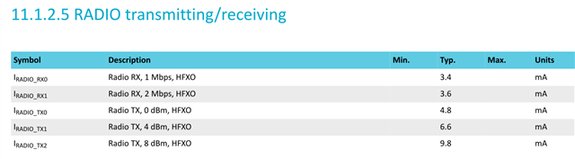

Hi Nordic Teams :
I would like to check the current consumption by BLE DTM.
1. Is the table measurement is from 3.0V input?
2. I find the condition in the datasheet is 3.0V but my system is 1.8V. Is the current still the same as the table or I need to transfer the current by system power consumption 3(V)x9.8(mA) / 1.8(V) = 16.3(mA) ? (take +8dBm for example)
