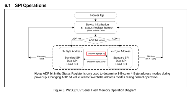

Hi ,
1.In the example: In nRF5_SDK_17.1.0_ddde560_usbd_msc_1\components\libraries\block_dev\qspi\nrf_block_dev_qspi.c, I need to set the following 0xB7 bytes. How should the driver be modified?

Hi Peter
First off, it's important to note that the nRF52833 does not support QSPI, so you can't use the QSPI drivers for a project running on the nRF52833. The nRF52840 or nRF5340 is better suited if you need QSPI. Thus I think you should rather use the standard SPI and send these bytes manually to the external flash after SPI initialization.
