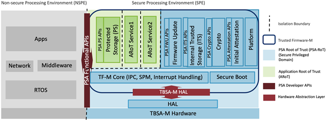

    The CONFIG_TFM_CMAKE_BUILD_TYPE_RELWITHDEBINFO symbol is for debugging the code in the Secure Processing Environment. Applications are running in the Non-secure Processing Environment and this Kconfig symbol should not matter.
